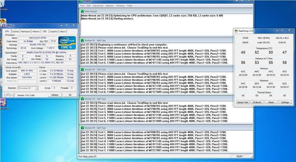

Hi, I am struggling to get P95 stable and seem to be encountering infrequent BSODs whilst idling at the desktop, but everything is fine whilst gaming.
It BSODs under prime (small FFTs) after just a few minutes with all workers running still and max core temp of 75*C. I'm currently 15 minutes into stressing with 1.208 vCore
How do these OC settings look? From what I've read this voltage is quite high for 4.3GHz
Multi - 43
BCLK - 100
vCore (load) - 1.200 (1.204 idle)
LLC - Auto
Any help would be appreciated, thanks
If you're blue screening I suspect you just need to keep gradually increasing the vcore until it stops. My 3570 isn't a great clocker at all an needs 1.296 for a stable 4.4 ghz. At 1.284 I could run 30 loops in IBT and prime for over 12 hours, yet it wasn't rock solid and would occasionally blue screen.

Hey Freddie. What cooling are you using? My temps get very toasty at just under 1.3v!
Currently testing under prime blend as I've found that harder to achieve than small ffs.
Passed a few hours last night before stopping it as I didn't want to chance it overnight until I'd done a long test whilst I can check up on it.
However, what was stable last night wasn't when starting from cold this morning but seemed my mem needed a bit more of a nudge to volts.
Currently testing;
CPU ratio : auto
BCLK : 100
Vdroop / LLC : auto
CPU core v : auto
Core ratio limits : all set to 43
vCore (load) : 1.168 acording to CPU-Z
Temps averaging 64c
2 hours stable so far and no WHEA errors in the event viewer, system log.
Mem running at 2133MHz 1.5680v
I usually leave mine running over night and if it's still going in the morning i'll leave it running until I get back from work. If no errors are reported in prime after that have a quick check through Windows system logs for WHEA warnings. If that's all good then a week or so of general use and gaming before being happy.
