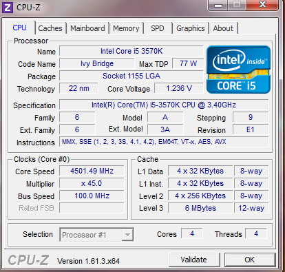

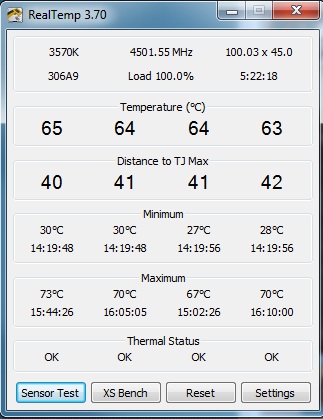

Large Image:
Lowering voltage of IGPU definitely reduces temps I've found. I've taken the igpu clocks and volts to their minimum that the bios will allow and temps drop by about 5c.
quick reset of igpu to stock settings and brief resume of folding temps go 5-10c above my average.
reduced it again and gone to first pic temps.
Only problem I've found reducing igpu is that sometimes if hardware acceleration is not enabled youtube videos may cause a bsod.
