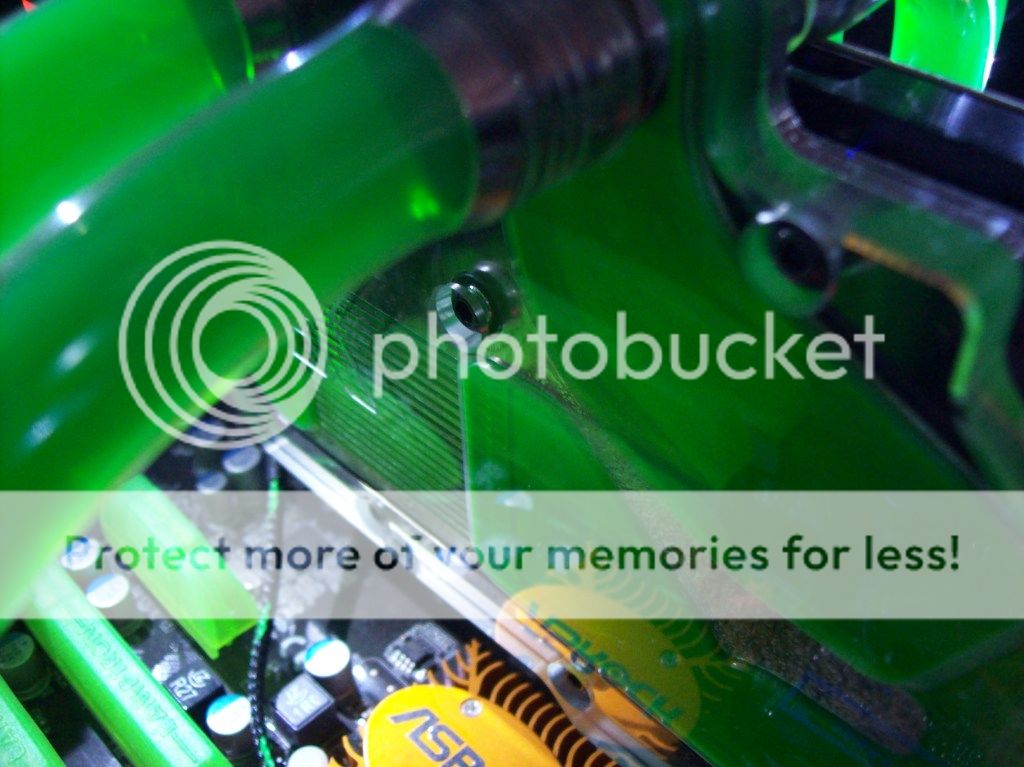

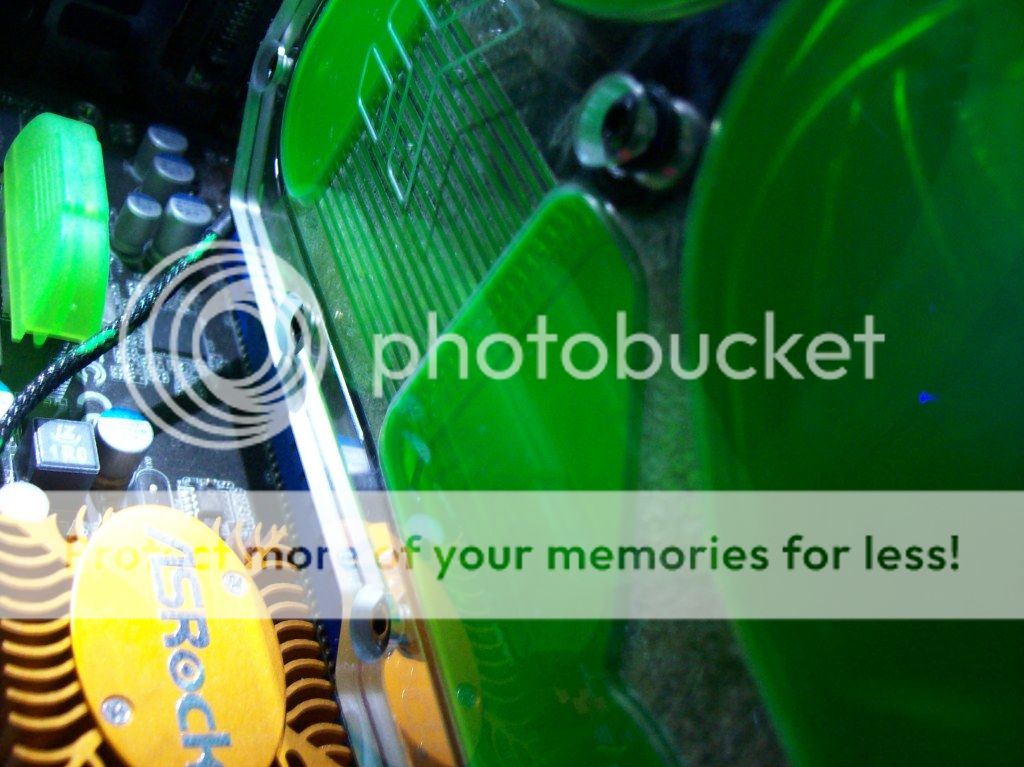

Ive found my lost pearls!!!
So ive had Mayhems Aurora Green fluid in my loop since about christmas, in the fisrt week or so my pearls started to disappear and to be honest, ive been past caring with everything else ive been doing.
But I had a quick look today to see how many were left as it just looks like green fluid now and is quite clear.
Anyway, there are no pearls left but I do believe ive found them hiding in my graphics card block, I have a 580 GTX, again, bought at christmas time, have a look.
See between the waterways over the GPU and again where it loops around back to the top of the card, its all glittery!
This doesn't extend all the way up between the barbs, you can see in the 2nd pic it stops around the area of the screw.
The card is in a Mountain Mods HG2O case so is mounted with the barbs being the highest point, not sure why this should make a difference but it obviously does.
Its not affected temps at all, they're still the same within 1-2 degrees.
