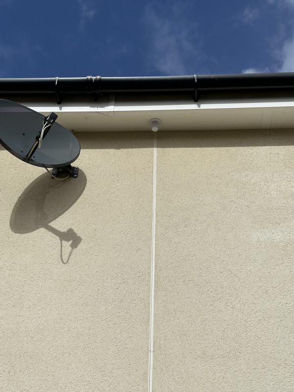

If you do what @ChrisD. suggested then you’ll have all the coverage you’ll ever need. He posted pictures of his own install and it was extremely neat.
You can see the AP here near the Sky dish.

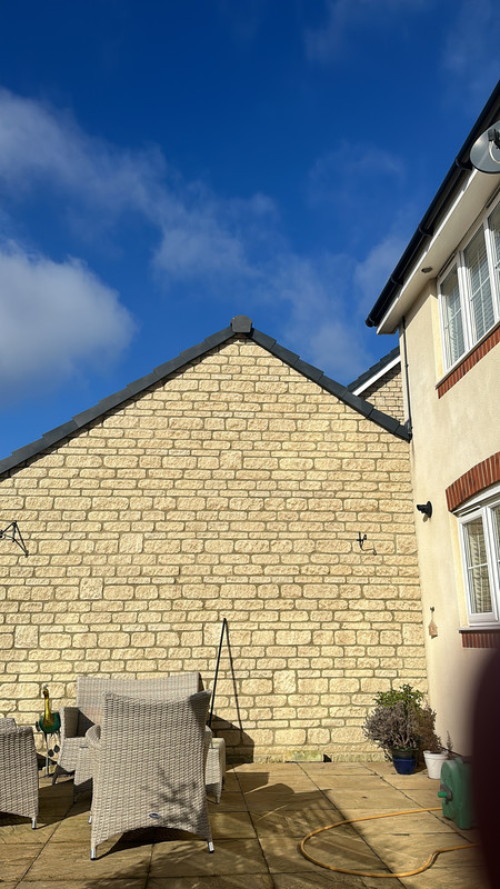

And its relation to the garage. I won't be setting any Wi-Fi speed records in the garage, but it's enough for my Sonos Roam and YouTube vids, I even did a Zoom call in there when I was 'working from home' but actually laying some flooring.
