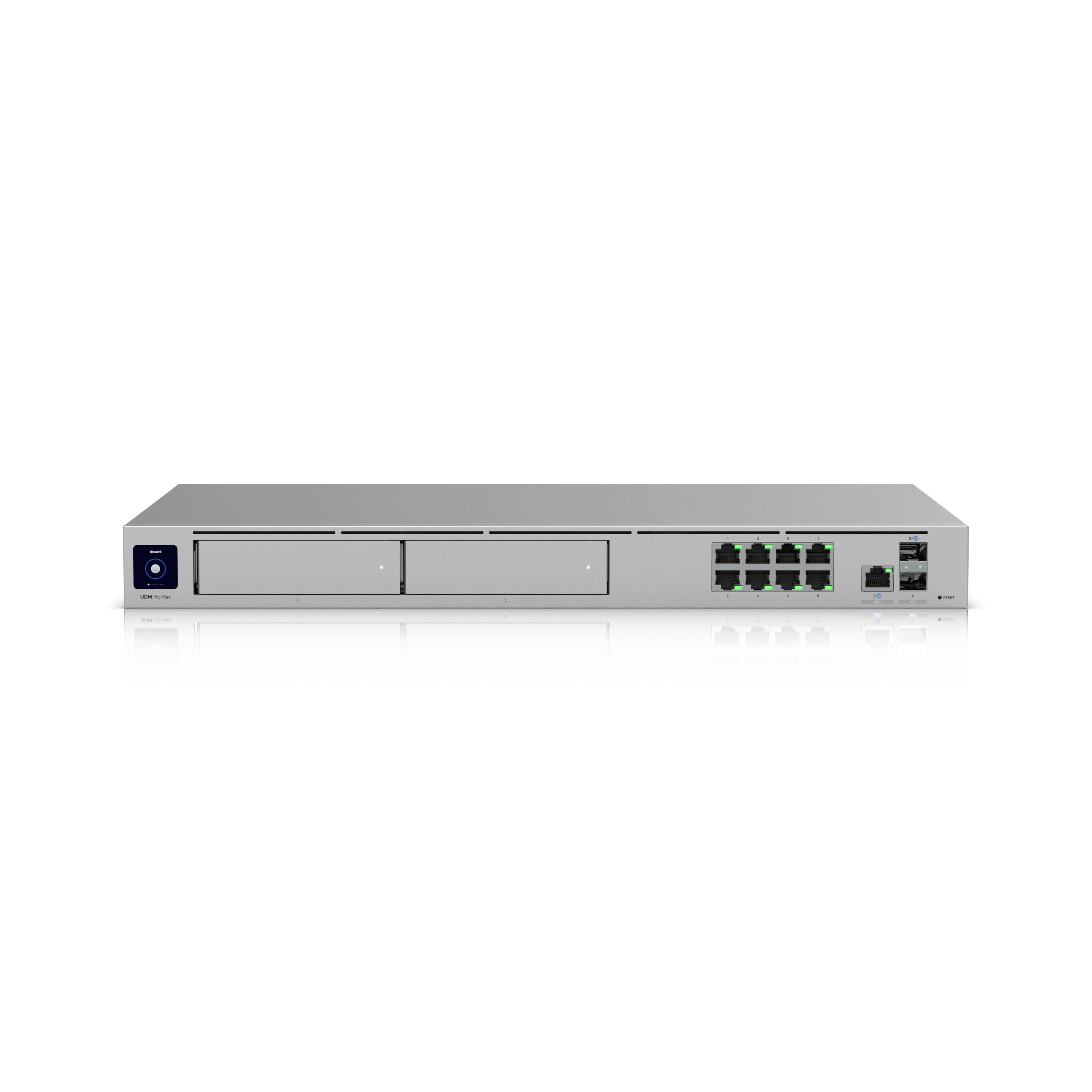

Looking at getting a Dream Machine SE, do ubiquiti ever do any discount codes or am i inevitably going to have to pay full whack?
Everything I read/googled suggested it’s a full price only option. Especially on high demand items.
Best option is seeing if a reseller has TCB or something.
Got mine here £468.
