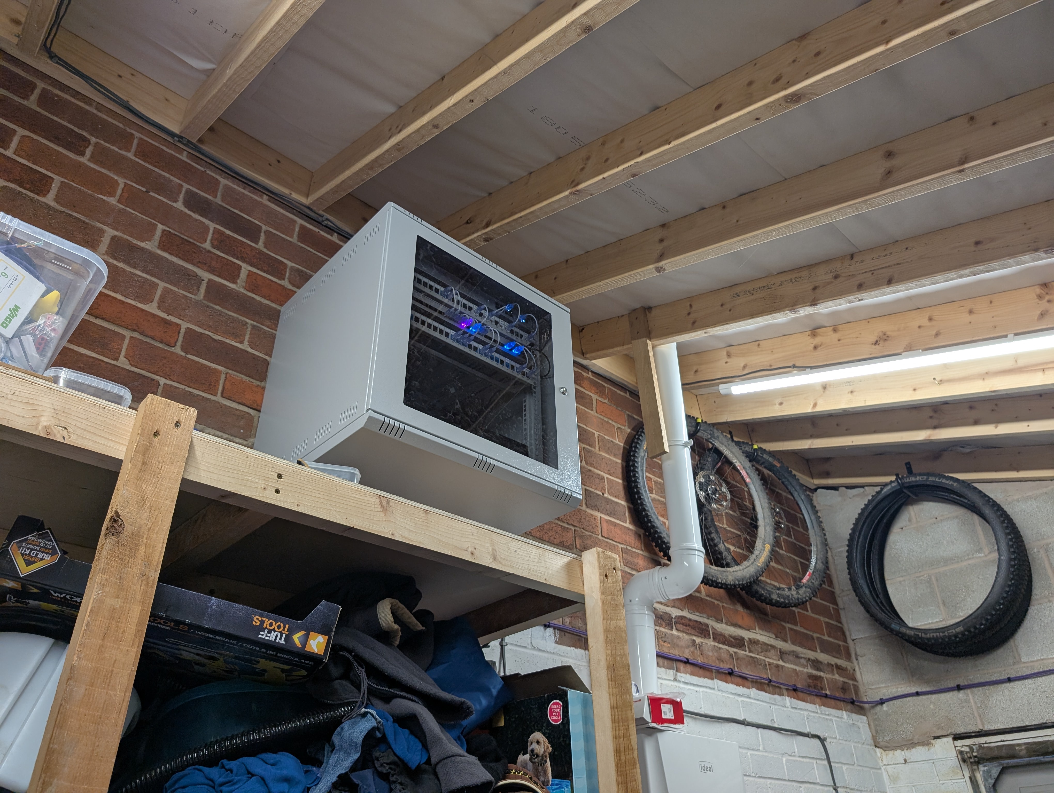

All done.
Before.ter
Few more devices to add in. But plenty of space for expansion.
Looks mega. I always find cabs wall mounted quite uncomfortable looking (brain overthinks the cantilever effect). I never question 600 deep kitchen units full of plates though :cry:

<snip>
I appreciate this is at home and rack space isn't an issue, but please try NOT to get in the habit of spacing rack kit out like that. I've lost countless hours trying to re-fit kit in a live rack that's straddling a rack unit.
Look at the spacing between the screw holes and you'll see they're not identical and that can cause a problem.
What? It's spaced for practical reasons, I can fit my fingers in and insert new points without removing anything, no one else is ever going to be touching it. Not really sure what you mean about the screw holes not being identical.
The spacing between the holes isn't identical all the way down the rail - in my pic there is a difference between the size of the spacing shown as red and those shown as green
The screw holes themselves are identical, but the spacing between then isn't.
The UDM-SE at the top is spanning 2 rack units. The top 2/3 of of the top rack unit and the the top 1/3 of the second rack unit. This sort of thing really matters in an enterprise environment, particularly when you've got bigger, heavier bits of kit and where kit has rails with captive screws. It's a real ball ache to have some kit straddling rack units because due to the difference in spacing between the screw holes you'll often find kit won't screw in. Sorting that sort of thing once the rack has been cabled up is a complete nightmare.
As I said, I know this is your home rack and space isn't an issue so feel free to ignore me but it wouldn't surprise me somewhere down the line you find something doesn't fit into your rack and this will be the reason.
In a business install yeah that would result in ridicule and some DC would actually force you to correct it, at home not really an issue.
Depending on the rack they sometimes have a little arrow pointing to centre hole for the U or they can be labelled and underlined per U.
