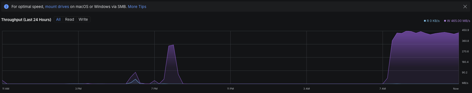

Getting around 450 MB/s copying large files from TrueNAS using rsync to an NFS export from the UNAS 8.
LnZe7THB
The drives in the UNAS are pretty old with smaller cache, I expect speed to improve a little once I swap them out with the 16TB Exos I have. Currently 4x Toshiba 14TB drives (1xMG07, 3xN300) and 1x 16TB Exos in RAID 5. Once the data has moved I'll end up with 6x 16TB Exos in RAID 6 and a pair of SATA SSDs in Raid 1 filling the two remaining bays. I'll have to see how the cache performs once I start using it for real. I'll have a spare 16TB Exos I'll keep in case of any drive failures, and I'll repurpose the 14TB drives as backups in the UNAS 2, might even get a UNAS 4 too.
I really like the simplicity of the UNAS. Wishlist now is a decent app on IOS, hopefully some performance improvements, and more backup options.
Found a few bugs which I've been reporting, but so far very happy.
