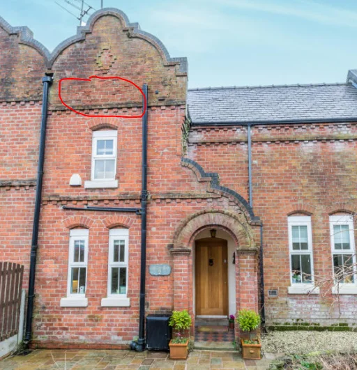

We're buying a property that was built in 1874. There's a little bit of lime coming through one of the walls which we're aware of.

One thing i did notice was that when i was in the loft i could see some rays of light on the side of the loft which wasn't boarded so i couldn't get over to it to inspect. It's probably around this area. I'm also trying to work out why there's a drain pipe going into the loft (the upstairs window there is the bathroom)

Drain pipe may be there either purely for visual to cover up brick ties, or from previous drain/overflow from water tank?

By drain pipe do you mean the rain water collector and pipe on the left, which takes water from the valley between the pitched two pitched roof sections behind the facades or the effluent waste pipe vent to the right?

i believe as stated above the right hand side drain is the stench pipe, it doesn't run into the roof space but rather caps at the top of the pipe? All the advice is here is fairly sound. I would ask some questions of the vendor though, find out when the refit was completed, it does look like its been done to a good standard but if it was recent it could be covering up some issues and it might take a while before they become known to you. I am actually studying to become a chartered surveyor and from the pictures it looks in decent condition. People need to understand that houses do not and will not last for ever, you can of course prolong the life of a house with regular effective maintenance but most people don`t factor in these costs. In my somewhat limited experience you can tell how good a house has been built by going into the loft, a decent roof normally means a decent house is underneath it. Not always true of course. Check that items that required it when the work was completed had the relevant planning permission and sign off from building control, for example if you look at picture 9 it looks like they have removed some of the old external wall to open the space into the lean-to conservatory. If you have a 2nd viewing check the corners of everything, windows and rooms for signs of even the smallest trace of any mold, if you find some ask about it.
