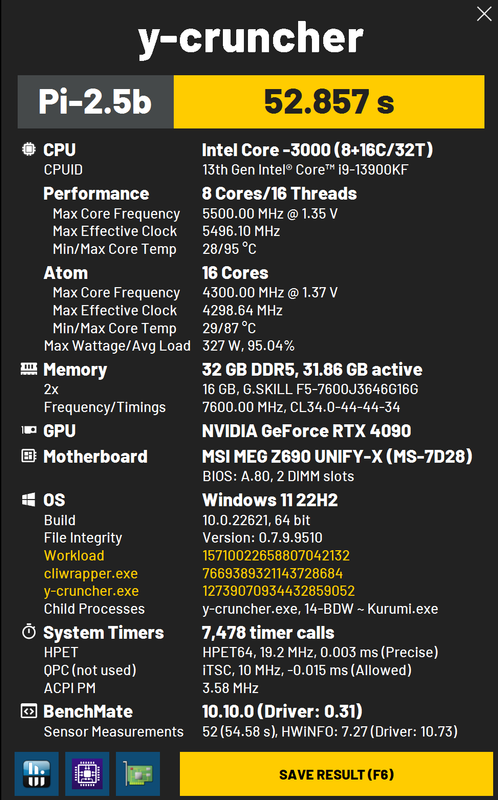

Insane cooling? I have a u12a, lol
13900k and NH-D15S

u12a with a 95c temp limit, handle 330w in ycruncher
Lol 330 watt fine temps on U12a. I tested NH-D15 at stock and loading CInebench it throttles immediately and temps hit 102C like right away and 340 watts of power. ANd 340 watts will degrade CPU as ut is over 254 watt Intel limit, And this is with P cores downclocking themselves to like 5.3GHz. Can run them 5.6GHz easy with e-cores off and no throttling at all.

I have a pretty average chip, 150 force according to MSI, so yeah, nowhere near the 1% top binned.
