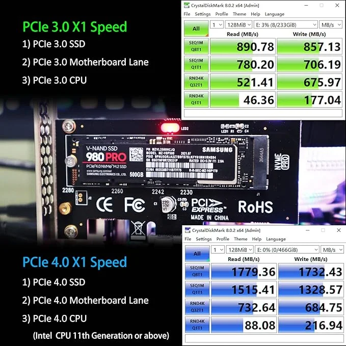

Just ordered a PCI-E x1 M2 Adapter that will work in a PCI-E x1 slot so I can install my old NVME SSD into my machine. Won't get fast speeds but still better than a SATA SSD and can use it for storage.

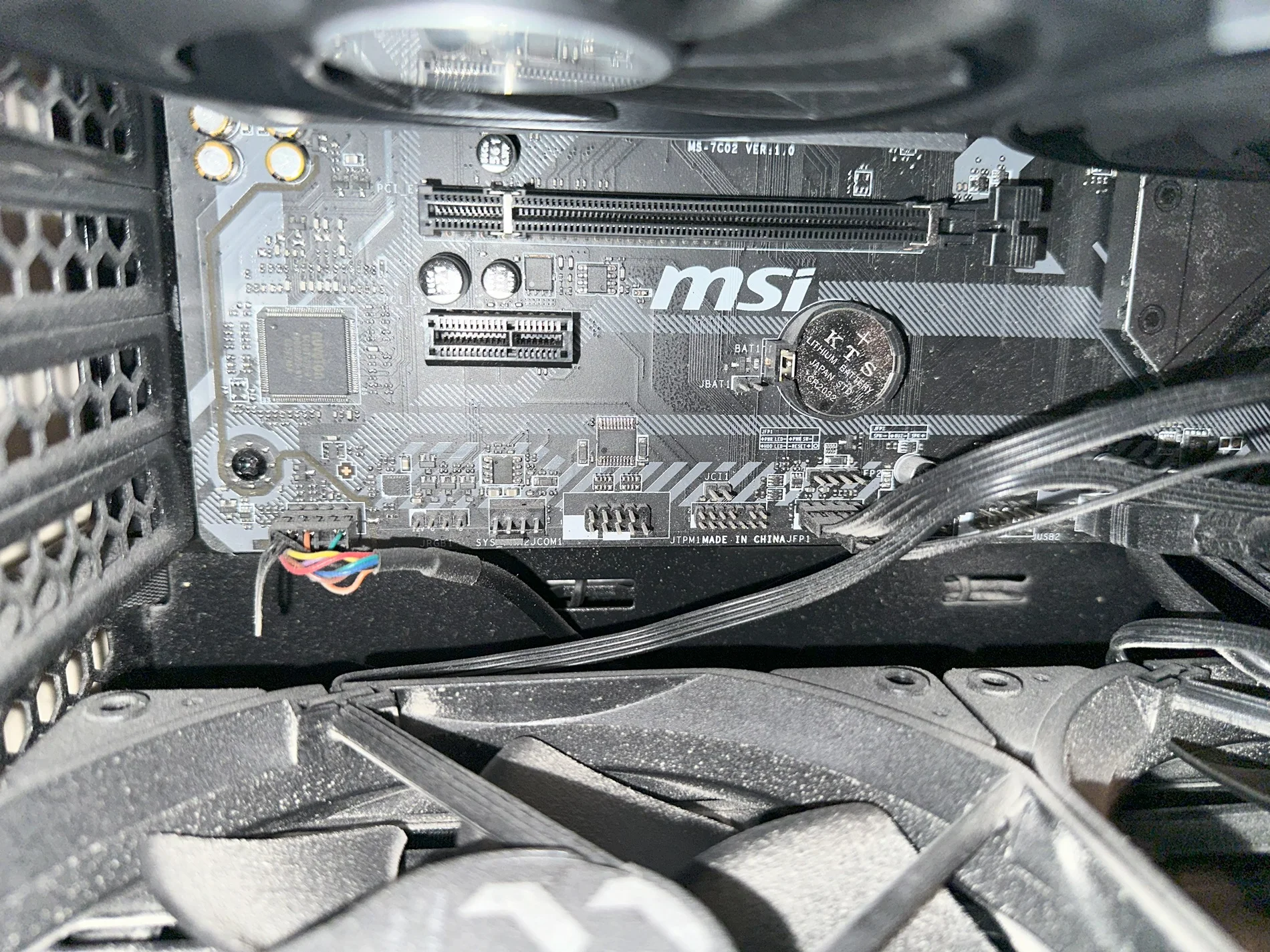

Can't make use of the free PCI-E x16 slot as its blocked by the graphics card.
Potentially not, as you'll be limited to PCI-E 2.0 1x, so 500MB/s, SATA can normally achieve slightly higher than that,
It's not a 4 slot GPU (assuming you are using the B450 Tomahawk/MSI 7900XTX from your signature)?
If you've got the extra support bracket fitted to the GPU, you could remove that and use a different GPU support if needed?
This is what they reckon I should get @ PCI-E 3.0 1x speed...
Except that's not what your motherboard Specs say...
  • 3 x PCIe 2.0 x1 slots1
The GPU fans are underneath it, and there is no way I’d be able to fit a PCI-e card there. It would also block the fans if I did so.
I don't see how that's true?
The 7900XTX is a 2.5 slot card, there are 2 slots between your two PCI-E 16x slots on the Tomahawk, so it will not block it
As an aside the specs for PCI-e aren't always correct - for example some of the Z790 boards say PCI-e 3.0 for the chipset slots but will actually do PCI-e 4.0. It is worth checking the BIOS to see what the options are.
The manufacturer says 1 x PCIe 2.0 x16 slot, I don't think they'd get that wrong, and the board is from 2018. The PCIe x4 M2 adapter was £12.24 and the PCIe x1 M2 adapter is £7.87.
