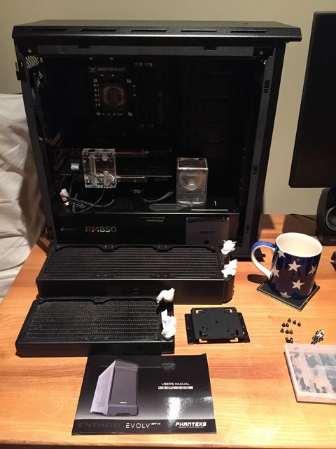

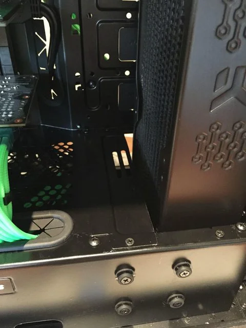

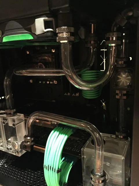

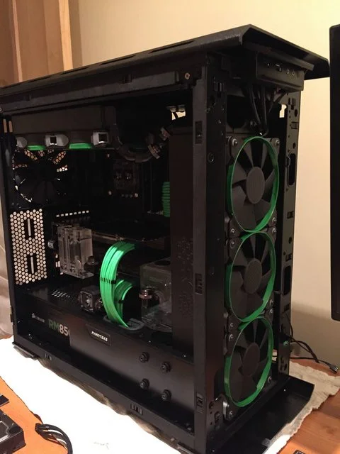

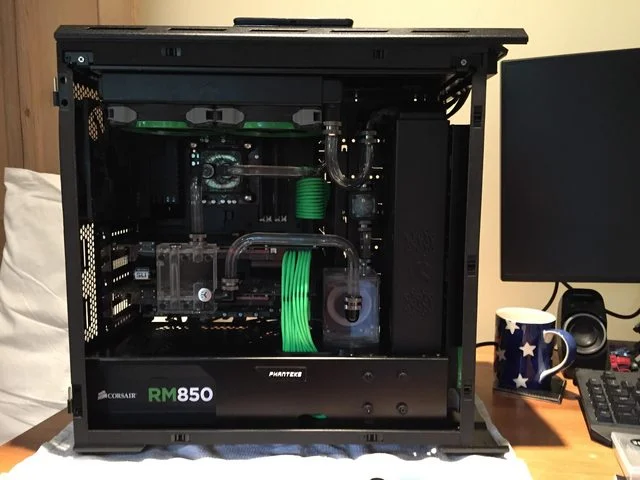

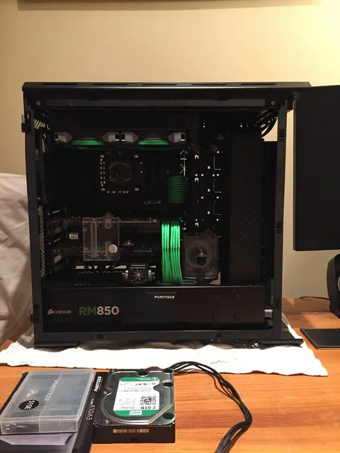

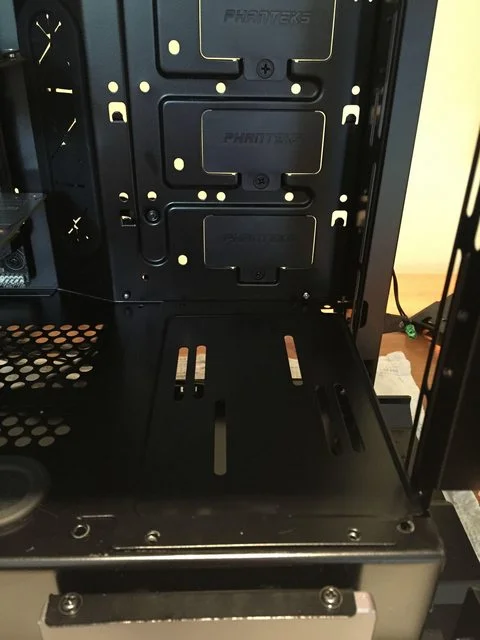

Overall I really like this case but I in my opinion a few things could be improved;
1) I didn't like the white PCI covers. I swapped them out for black ones.
2) The plate that sits above the HDD cage had to be cut in half to accommodate the res and rad as shown in the pictures. This could have been designed as a split plate.
3) The PSU cut out looks ace but is covered when the side window is closed.
4) The most annoying bit....the HDD mount located at the bottom of the case should be included with the case! I had to buy the optional accessory. If you mount a 360 rad in the front you can't mount a HDD anywhere without this additional mount. For a case designed for water cooling in mind this should have been included.
Other than the above minor points, this is an excellent case and a joy to work with.
Here are some pictures of the build;
Thanks :)
Cracking build very tidy, best I've seen so far :)
Having the split Mid Plate option would only really work if it lined up with the rad size you were using.
White PCI covers are a bit odd, maybe they are to match the White Blade Fans, I took the fans out as they matched nothing I was using.
The case design does have a few bugs, so perhaps there will be a Revision 2.
