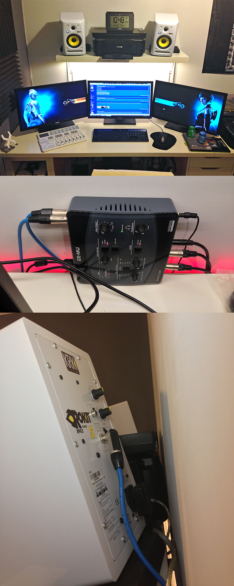

Here's the pics of mine, not an idea setup space wise but it works and actually sounds pretty good due to the angle on the tweeters towards my head when sitting.

I bought my gear as I do a lot of video editing plus music production and wanted a good system that wasnt going to break the bank that was ideally suited to the small room I have.
I bought Sound on Sound magazine and the special editions on monitors and studio space. I read all the reviews on everything from the uber cheap M-Audio (which really DO have problems) through to the ribbon tweeter Adams and so on.
The KRKs got a good write up from real world testing by the author of the article not just from marketing bumf and Ive seen them used in different studios across the world so thats why I went with them. I am very happy and yes it is mind boggling how a small frame can deliver such potent output but there you have it.
