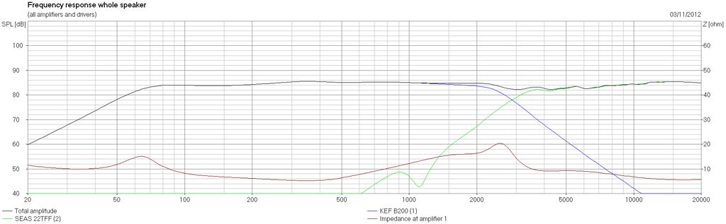

This is the frequency response plot for my home made Kef chorale. Not likely to get much flatter than that.

Note that the first speaker is a hi-fi bookshelf speaker, the LS3/5a is a BBC monitor designed for speech work in OB vans. (mobile studio) I highly doubt that either would perform anywhere near flat in my room, simply because my speakers are squished into the corners of the room and i little in the way of soft furnishings.
