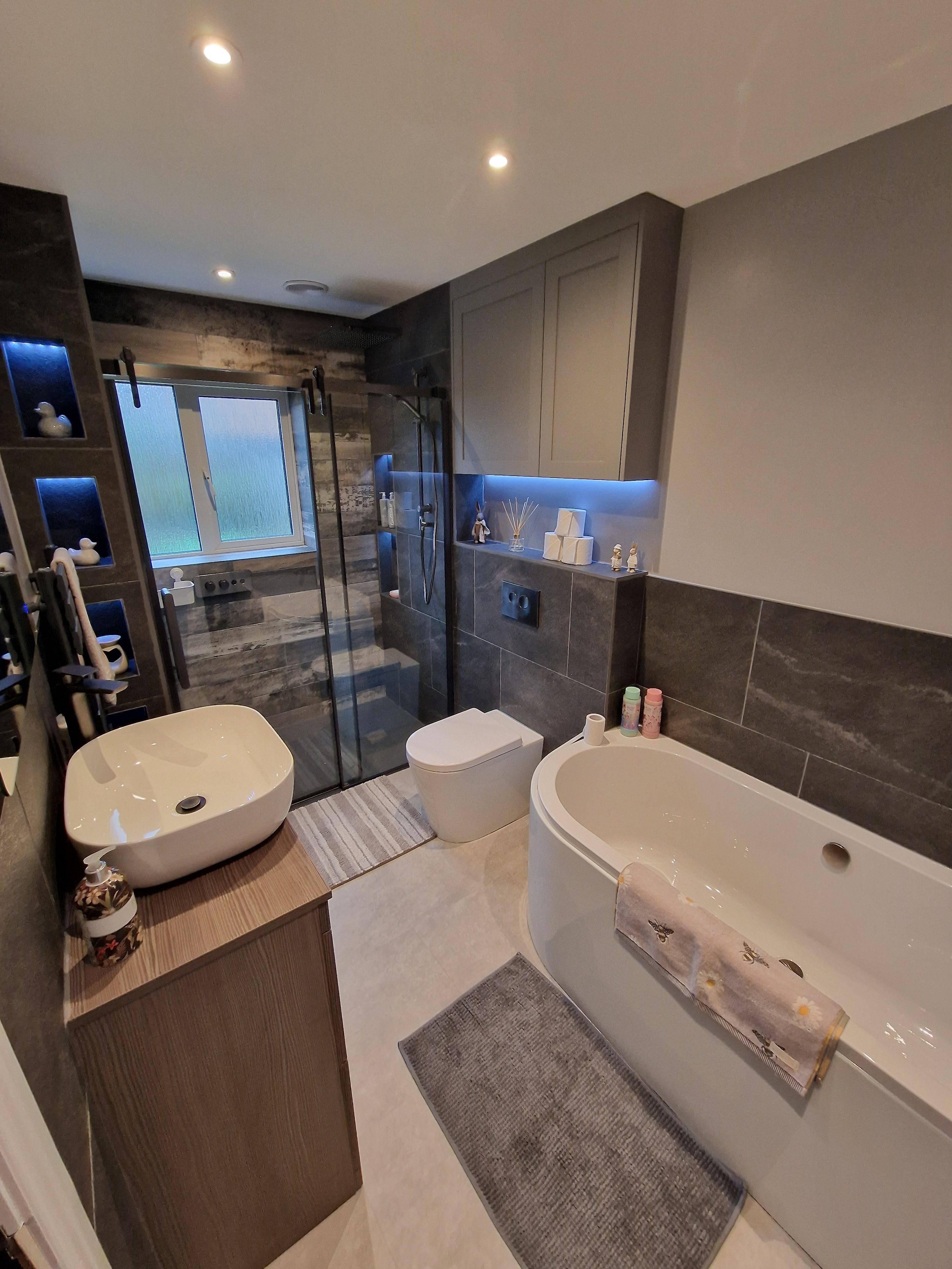

P.S. it looks mega!
Appreciated, I'll post a pic of the full room when I get chance

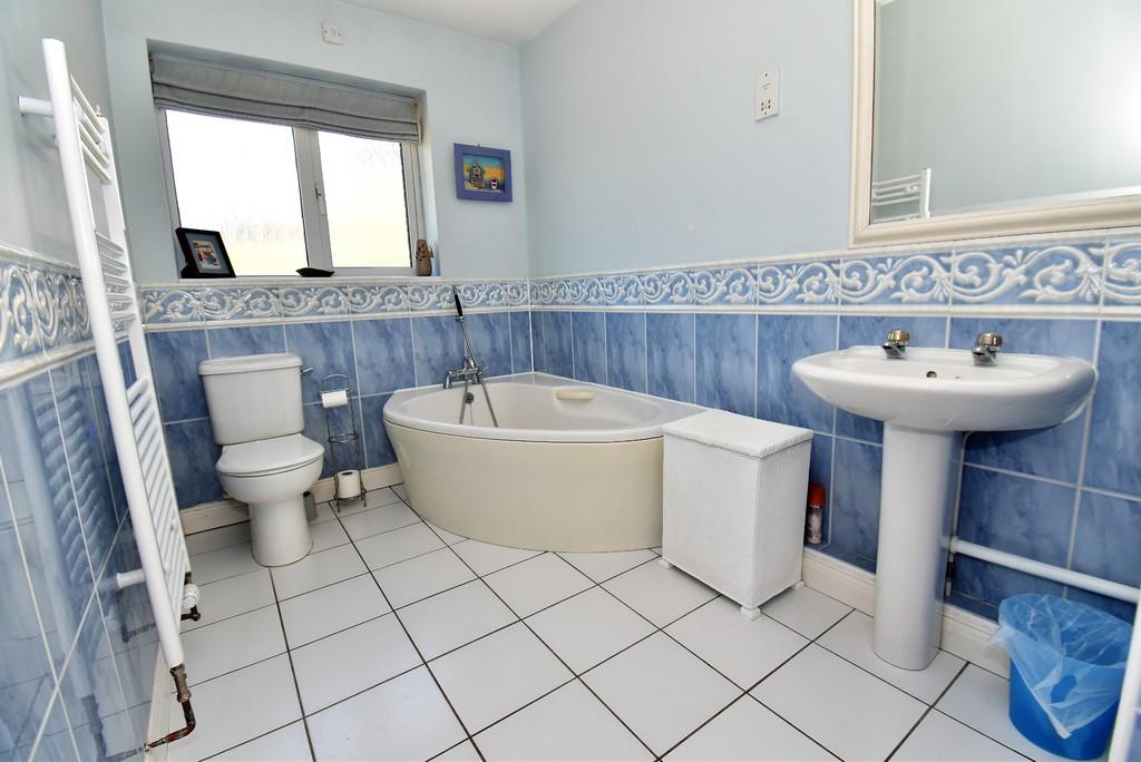

Pics
Before
now
