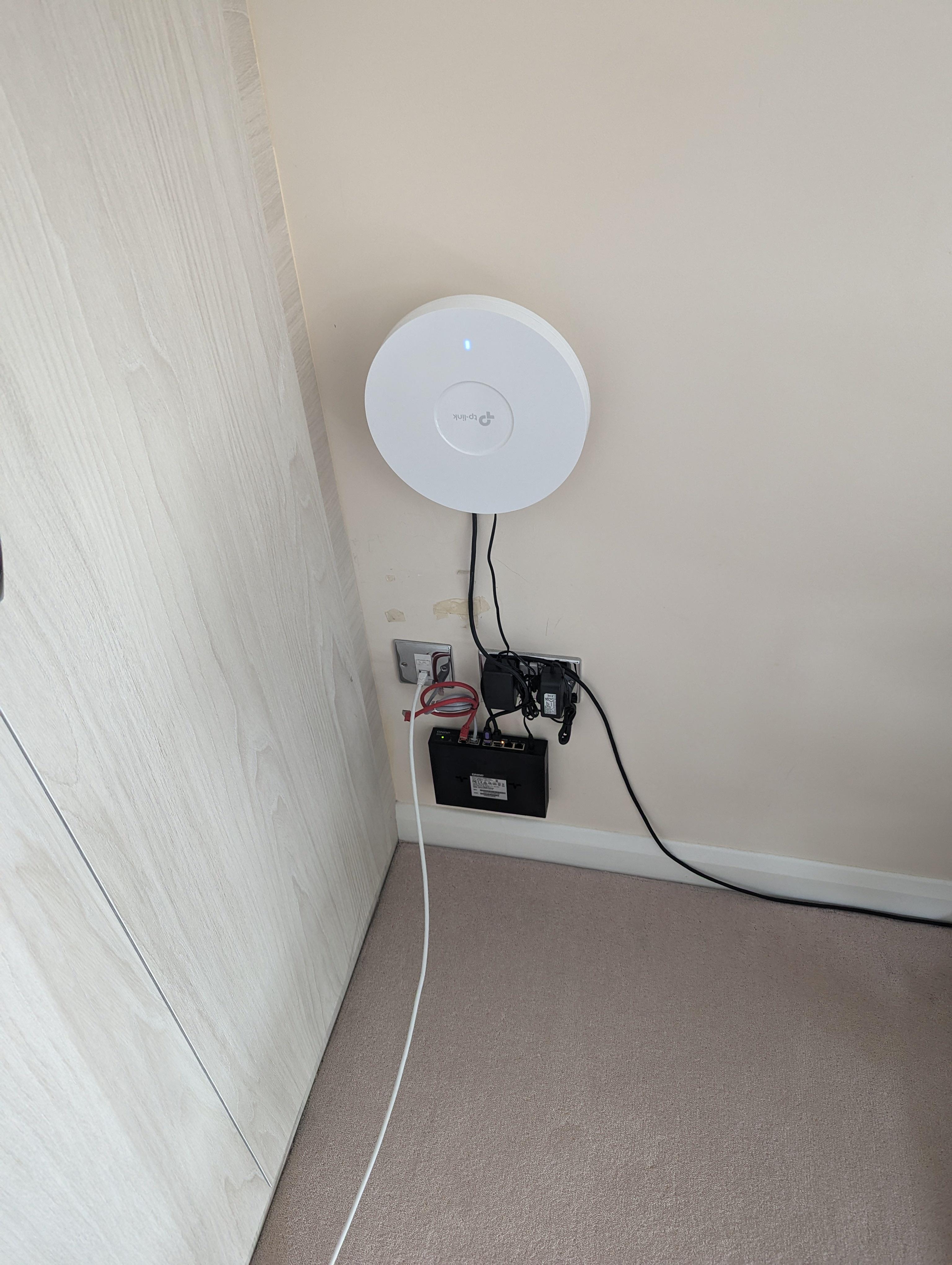

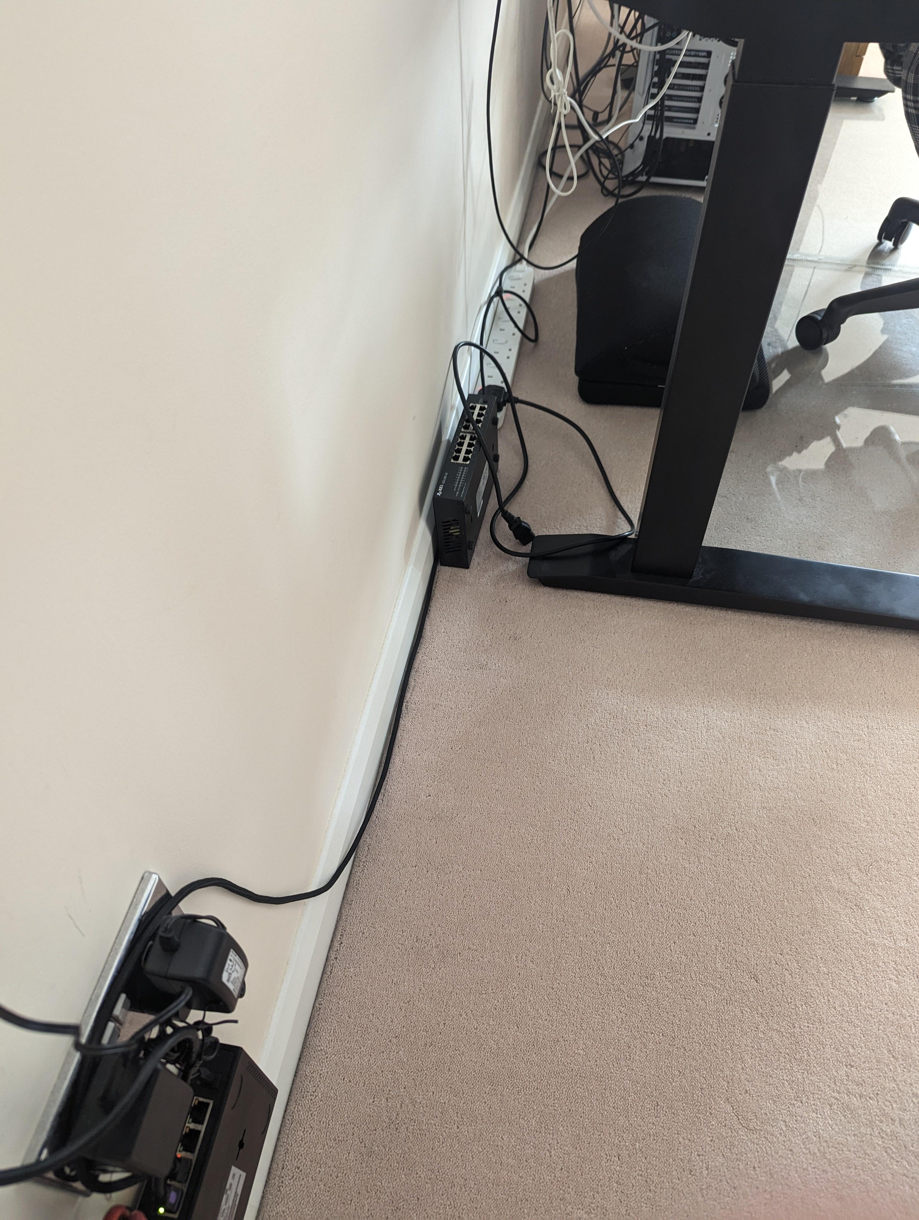

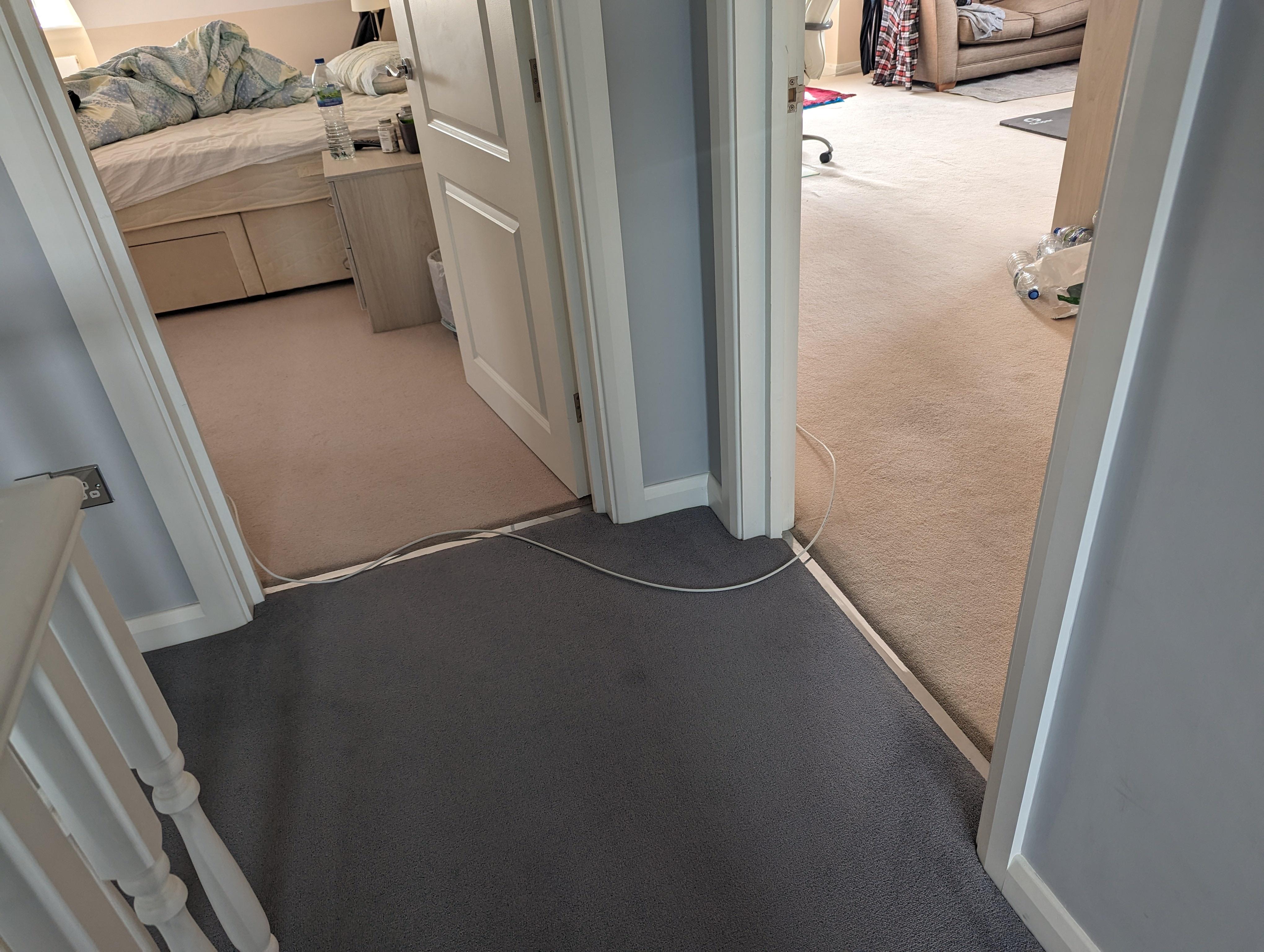

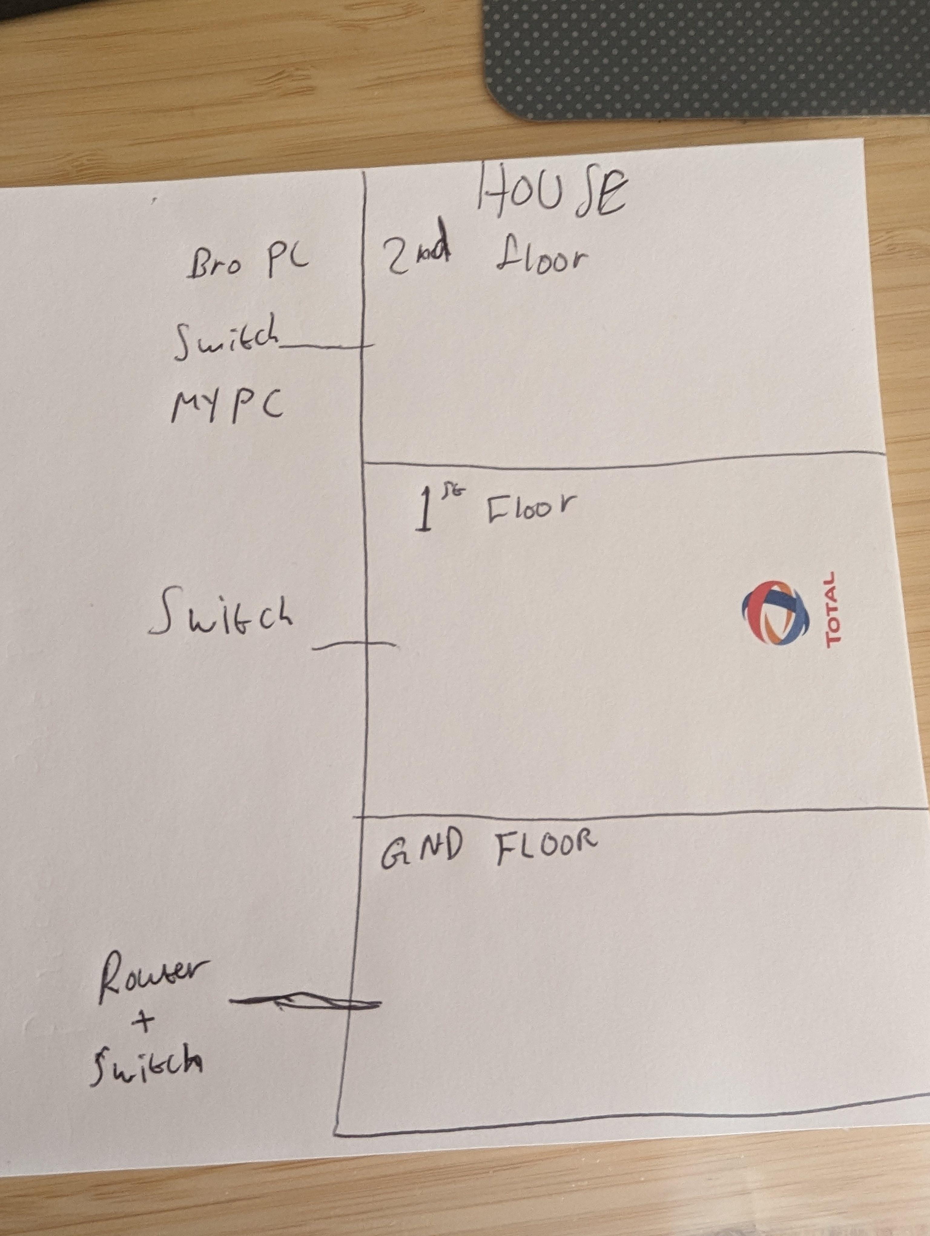

Im going to attempt to show the layout in pics and words LOL Im no artist or network architect by any means LOL here we go (EXCUSE THE MESS)
The Layout
Ground floor
2nd floor rooms
Brothers PC + Switch + Wall Port
Wall port in my room
Switch + Wall Port + AP all in Bros room
The thought process behind the 'network layout' was to have 1 LAN port off the router feed 1 floor of the house with a switch on every floor to feed all the APs and sockets. So 1 cable from 1 port goes to 1 floor which then feeds a switch, and that switch then feeds all the ports on that floor (one in every room and on landings). That was the thinking at the time, whether it was a good idea or not, i still dont know! LOL
And the thinking behind that was to spread the 'load' across the ports rather than having 1 port getting absolutely hammered....again not super knowledgable on the inner workings of routers/switches but was i along the right lines? Would it have been better to have just 1 switch coming off 1 router port which then fed the whole house?

Ive put pictures to try and help it make sense.
This is where the 'electrician' slightly messed up.....the other end of my wall port is the gray cable coming out from under the faceplate in my brothers room

Three things of note here.
1. I wouldn't touch brotrends/nicgiga with a bargepole.
2. Don't face your switch ports upwards if wall mounting, they'll fill with dust etc.
3. Best not to daisy chain switches too deep. I'd get one big one of a decent brand and run cables.

Also, unfortuantely, the diagram and photo's you've provided don't show how everything is connected. And the photo's don't show enough where we can reverse engineer a picture out from it and know what's going on. How exactly (for example) does your wallplate connection reach your brothers room? Because from the photo's available, there's no way to tell. If it's fitted inside the walls itself, where is the other end in your brothers room? Or is it going from your room down to the ground floors network room and then back up? In which case, where does the connecting point in your brothers room come from? All of these details impact on checking where potential issues are arising.
However, given the state of that wallplate connection in your brothers room, I imagine the fault is likely there if that then transfers over to your room.
The person installing that data cabling not realising you can get a double module outlet and having the cable just exit the wall with a plug crimped on the end has convinced me that all the problems are with the terminations of these cable runs.
