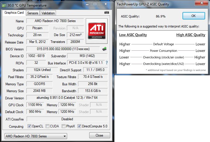

What's your ASIC quality?
78.8
EVGA GTX 570 Superclocked
51.4%
Is that gash? I am uisng some pretty old drivers, does this make any difference?
The numbers seem a bit meaningless but trend I've seen - which actually seems slightly different to what the GPU-Z author suggested:
Cards with low number <=60% seem to run fairly hot but overclock well, respond better to enhanced cooling than they do higher voltages.
Cards with >60% don't seem to overclock as well on stock but respond better to extra voltage and get good results when watercooled and a voltage boost.
What does Asic actually mean?? GTX 680 at 100%
thanks surveyor. So in theory my 570 should be a good clocker but bad for taking more voltage?
Ill test this theory out tonight as I have never overclocked it.
Means nothing, 74%, 71% and 82% for each of my cards, the one that is 74% out clocks the other two by nearly 100mhz.
After quite a bit of passively noting the qualities and characteristics of various cards I've had my hands on the only thing that the ASIC quality seems to definitely indicate is the power consumption of the cards - those with higher percentages are almost always lower power consumption than a comparable card with a lower ASIC quality.
How warm the card runs is also generally inline with what GPU-z says with lower cards generally running warmer the mixed results for this might be due to the temperature sensors not being the most accurate sometimes.
In terms of the overclocking abilities and how well they respond to voltage or what level of cooling your using seems very hit and miss I don't think the number fully represents the characteristics of the materials to a high enough level to be a reliable indication there.
