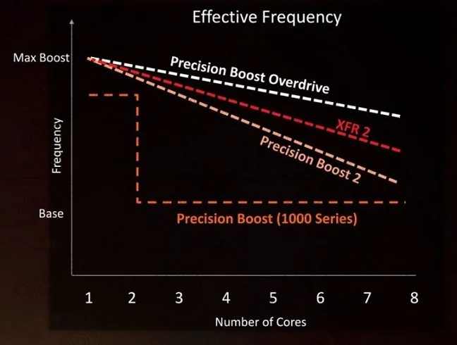

FWIW Precision Boost Overdrive can be thought of as doing the same thing people do when they increase the thermal & power targets on GPUs, you're basically giving PB2/XFR2 more headroom.
For example, PB2/XFR2 will keep increasing the clock speed of individual cores until it reaches either X degrees or Y voltage, PBO basically increase those limits by a certain amount (i can't remember by how much)

Yeah but the way I've started to think of it is PB2/XFR2 is capped, PBO just kind of basically removes that cap

PB2 and XFR2 are two totally independent things.

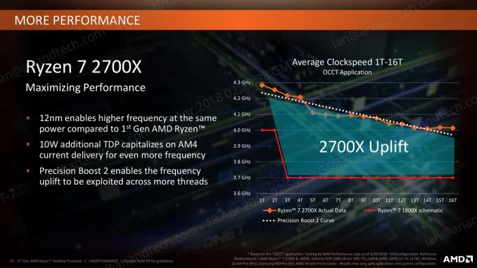

PB2 is the newer implementation of...you guessed it...PB1, which gives finer granularity over core clocks depending on how many cores are loaded. in contrast, PB1 only had this implementation for the first 2 cores.
(source: https://www.anandtech.com/show/12625/amd-second-generation-ryzen-7-2700x-2700-ryzen-5-2600x-2600/5)
XFR 2 is temperature dependent, ie, if your CPU is cool enough, then your all core speeds will be boosted, but vcore stays the same
PB2 and XFR2 is implemented in CPU microcode, so is independent of the mobo
PBO is different from PB2 and XFR2 in that it requires mobo compatibility (ie, not all boards support it). PBO takes into account temperature and voltages and boosts voltage for a higher clockspeed, if both temp and voltage are not at its limits.
the issue with PBO is that it tends to give too much voltage, hence the CPU will hit its temperature limit faster - therefore if one uses PBO, one will preferably require a negative offset (anywhere between 0.05v to 0.1v) to hit the max PBO boost clocks.

shamelessly stolen image, but i think explains PB2, XFR2, PBO very well.
source: http://www.xanxogaming.com/reviews/gigabyte/b450-aorus-pro-wifi-english/4/
