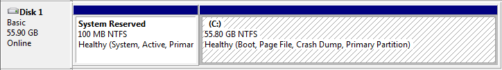

This only started yesterday and the only things I did yesterday was install a couple of games (The Witcher Enhanced Ed and Crysis Warhead) after they installed I ran disk cleanup, defragged the hdd and ran a spybot scan. Now when I went into disk defragmenter I noticed that along with my C: there is also another disk listed called System Reserved (I did not defrag this one) Any help would be great.
P.S. I have an i7 2600K with one of the older motherboards (not revised) is this a sign of the problem with this series of mobo?
With the windows 7 install it will create a "system reserved" section, much like this:
Nothing to worry about.
The problem with the motherboards was due to the SATA ports degrading over time. What motherboard do you have? As its a 6Gb/s drive im guessing its in a 6Gb/s SATA port? Meaning it won't be affected by the issue.
