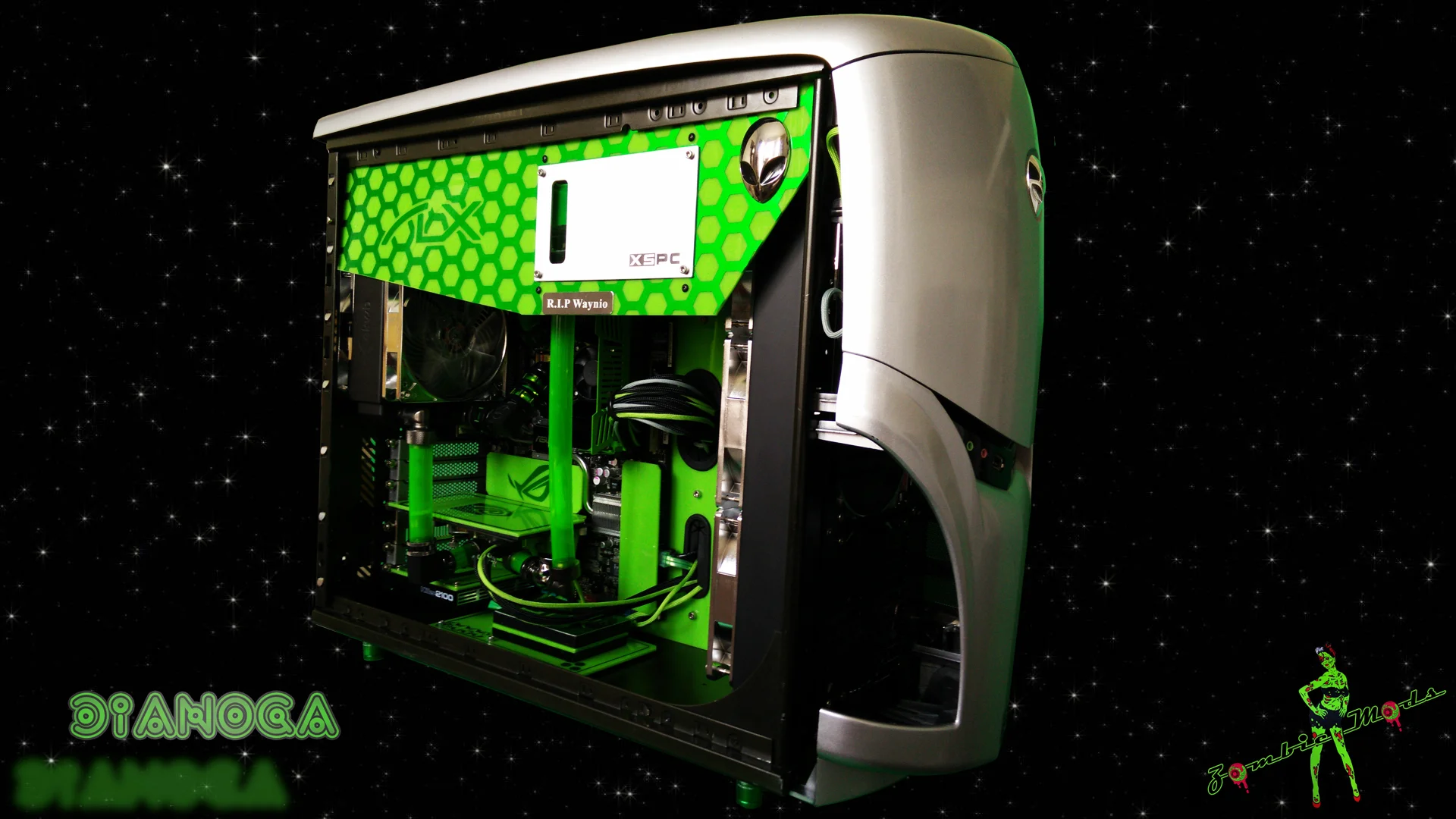

Update. This will be quite long due to me philosophising over water cooling and whether it was worth it or not. Not just worth it financially (note before I even begin, it wasn't worth it financially. It's cost me a small fortune even with half of it being free !) and as to whether the final result was worth it. I would say on that I am completely happy, thrilled even.

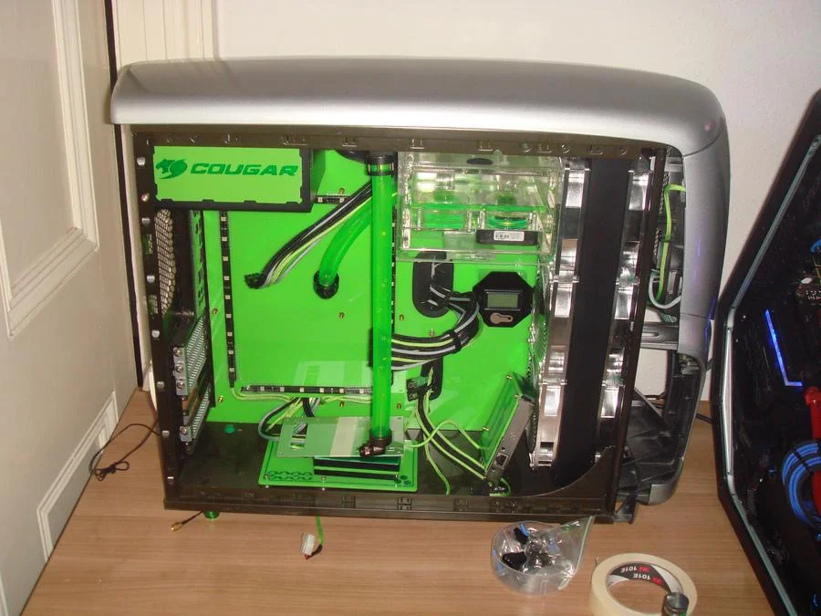

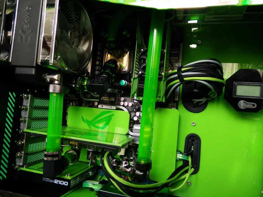

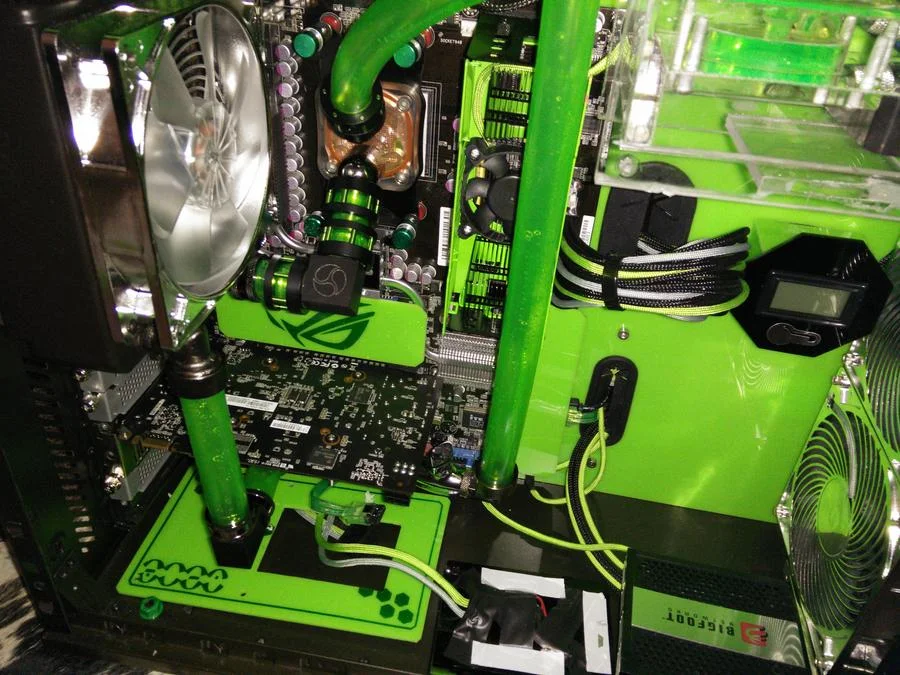

I've not been putting up rig pics for a while as I had to take it all apart again after the leak but I now have the face plate mounted up properly and bolted on (something I thought I was not going to be able to do due to a mistake I made :D ) but any way, just leak testing it now with paper towels etc so it looks stupid any way.

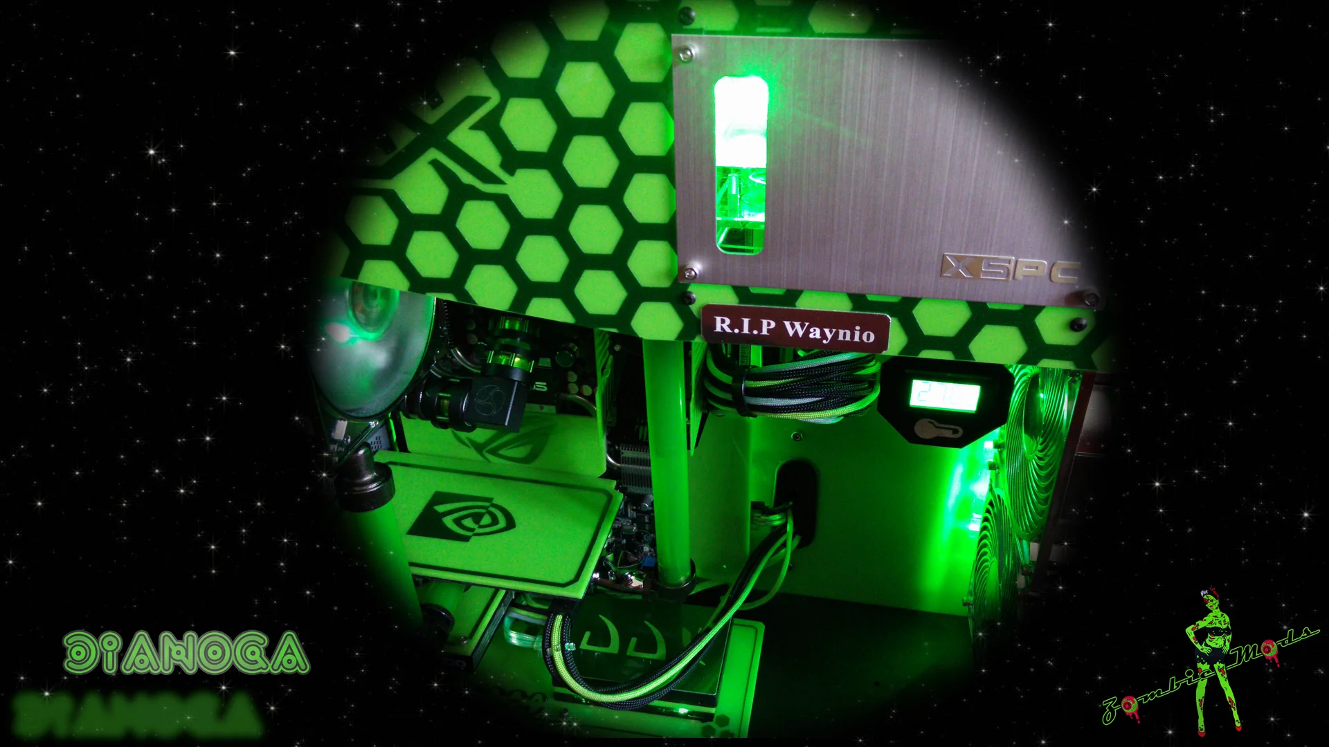

Even though this build is not befitting of the work Wayne produced and his incredible talent I would still like to dedicate this build to him.
Please open spoiler tag for pics. Cheers.

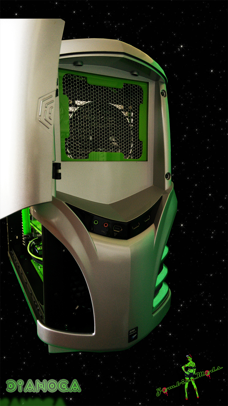

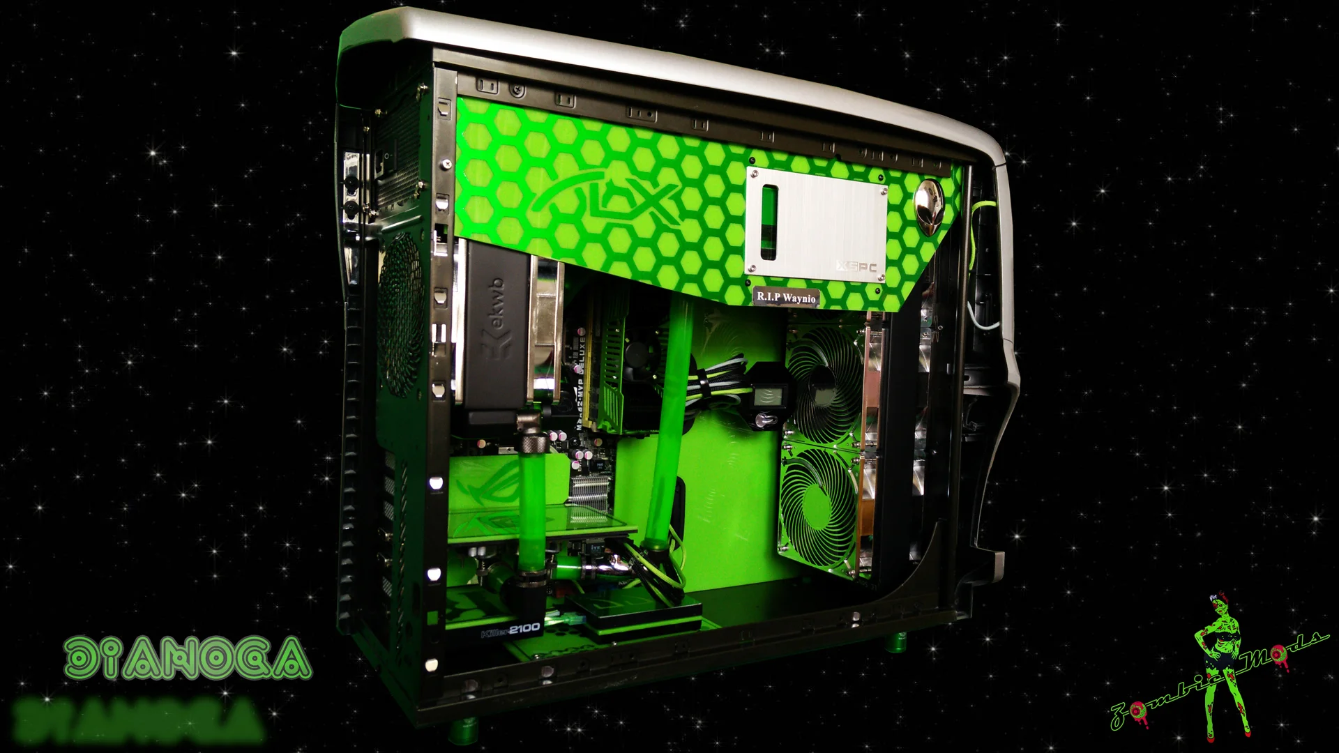

Dianoga, Redux.
OK so I pointed out that this build started off as a bit of a joke. However, once the parts started flooding in it got a little bit more serious than that. It reached the point where I was happy enough to make it a tribute for Wayne. The hardware though was pretty dire. Very old then, let alone here over a year later.
I have used the build quite a lot because I had networking issues with Win 10 where I could not watch any football streams. Plus it's damn near silent and I like Ubuntu a lot. However, due to recent events I am now needing a gaming PC to take to my mother's house. I recently put one rig on the TV so that only leaves Dianoga.

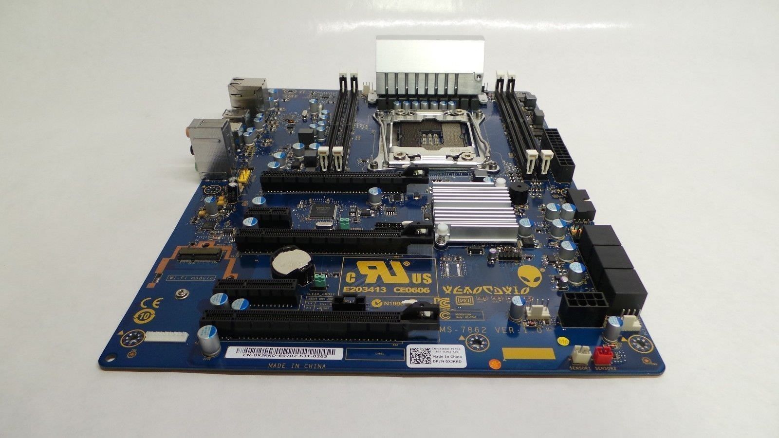

Last summer I overhauled my Triad rig with a 14 core Broadwell and new board. This left me with an X99 board.
It's a real ugly duckling. However, power that bugger on and you have a swan. Killer E2200, Intel Proset wireless, Intel Gigabit LAN, Soundblaster Recon 3D and so on. It also supports triple SLi and gawd knows what else. So it's more than man enough. I will probably paint the sinks all satin black and then try and make a full board cover for the first time. I will need to scan it, if it fits under the scanner of course.

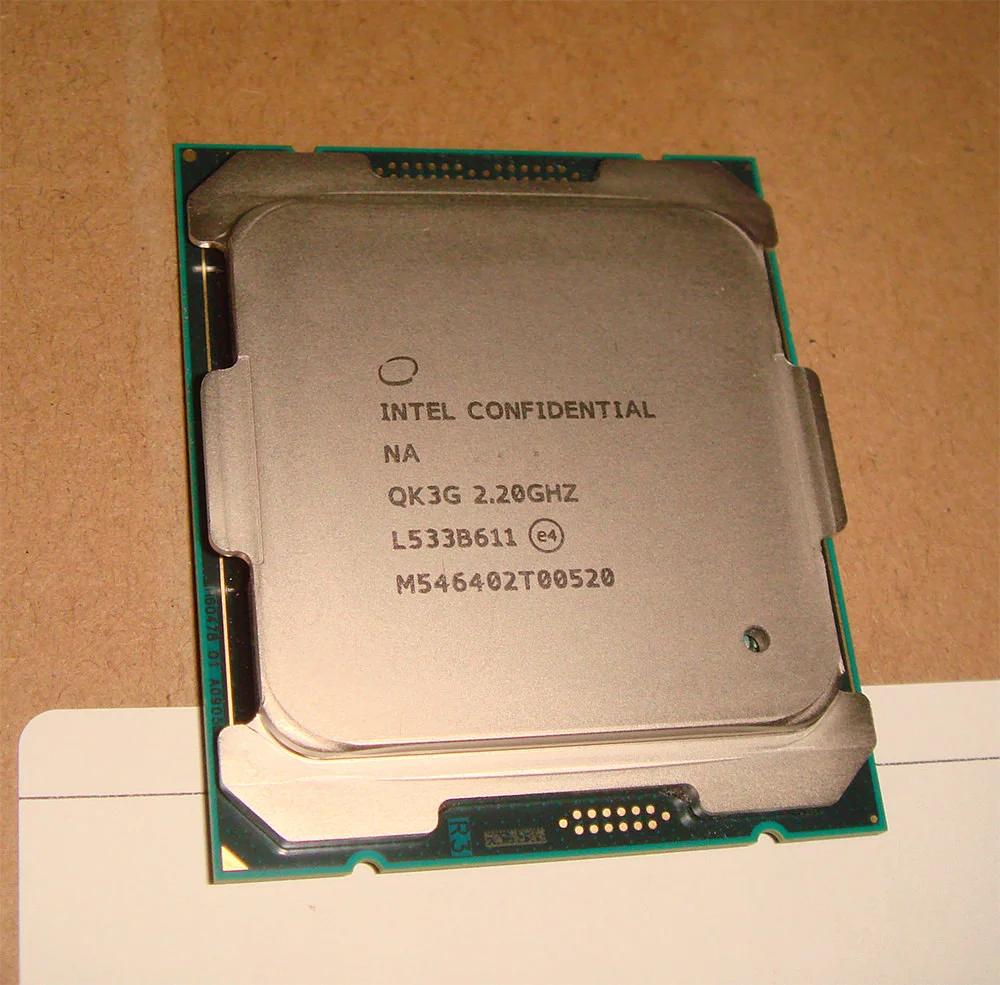

For the CPU I picked up one of these.
https://ark.intel.com/products/92981/Intel-Xeon-Processor-E5-2630-v4-25M-Cache-2_20-GHz
For £169 with the postage. Not got any RAM yet, but that will come last. I also ordered this from OCUK on the cheap.

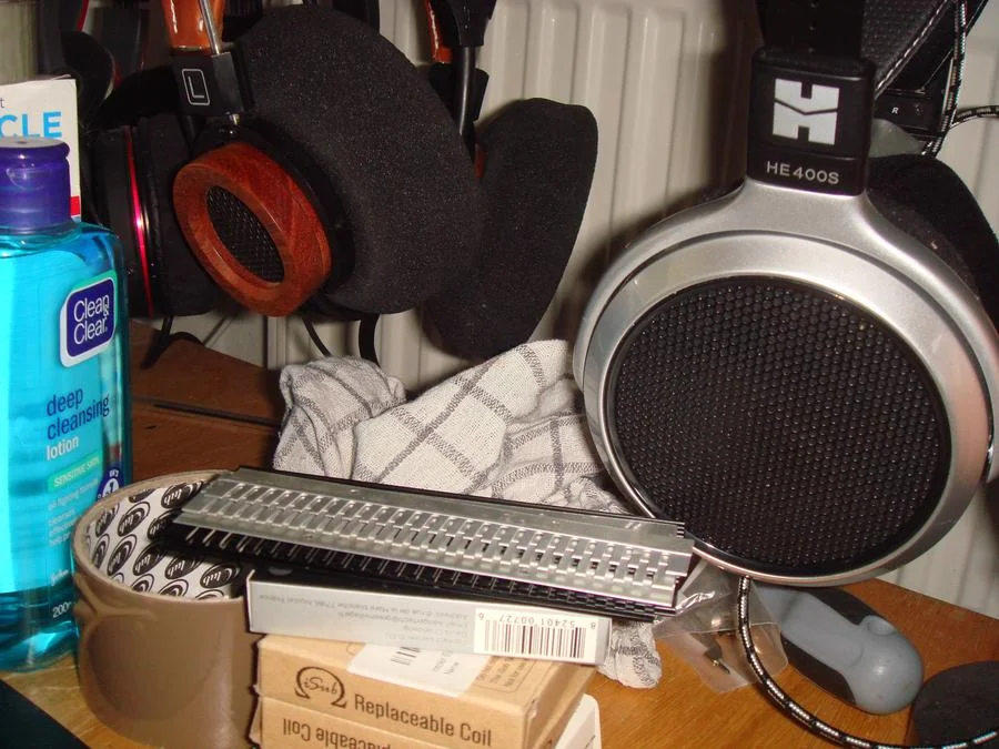

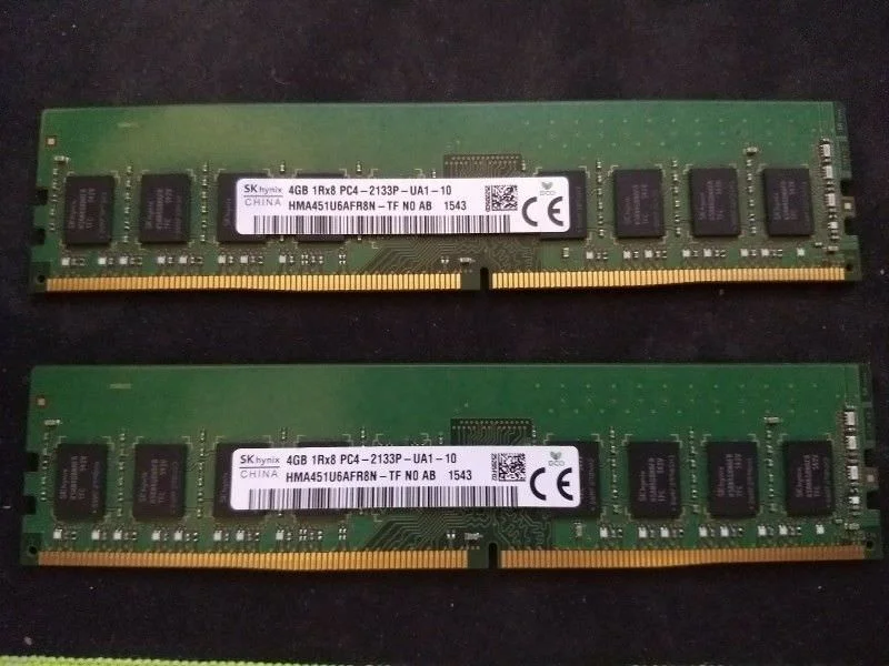

OK so I found some RAM. TBH? this was the most daunting part of the upgrade. I don't need to explain how much DDR4 costs now (hint - about a ton for 8gb). I really begrudged paying that tbh. A real kick in the nuts when you are on a budget. Any way I found these Hynix sticks on Ebay (UK seller) for £70. Offered the guy £50 offer rejected but counter offer of £55. I offered £50 again this time with a note explaining I really didn't have any more than that (which I don't it has come out of my savings for now).
I literally waved my arms around in the air like this.
All because I scored some bare green RAM for £50. Nuts isn't it? any way, after celebrating I started to think about how to make it look like £100 RAM. Pondered a couple of my usual "go to" coolers but then I spotted something out of the corner of my eye.
I had four to play with. I bought these for the coolers a very long time ago for a fiver (4x1gb DDR3 1800) so wasn't worried whether or not I would "Do a Dominator 2" and rip the entire chips off, cooler and all pmsl. I started to experiment and then long story short realised that you need heat. Lots and lots of luvverly heat. I burnt my ring finger tip so bad it's like glowing red. However, I got there in the end..
I did find out something very interesting about Corsair's methods of attaching coolers, though. Now when I heated this thing I needed to heat it to the point where there was literally smoke coming off of my gaming mat. Then you can pry them off quite easily. It was nasty gooey sticky stuff and I figured I would just attack that with white spirit and then isoprop to get them like new. However, I soon found out that once this stuff cools down it immediately turns to concrete and isn't sticky any more. As they would say in the Southern USA "Now ain't that a thing?". So I am going to grind it off with a wire brush on a Dremel, then polish with a rag end.

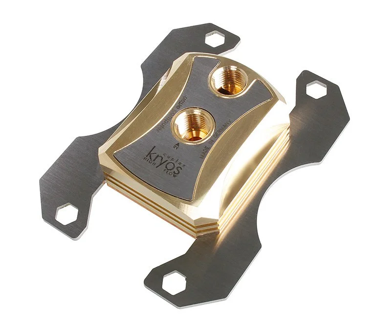

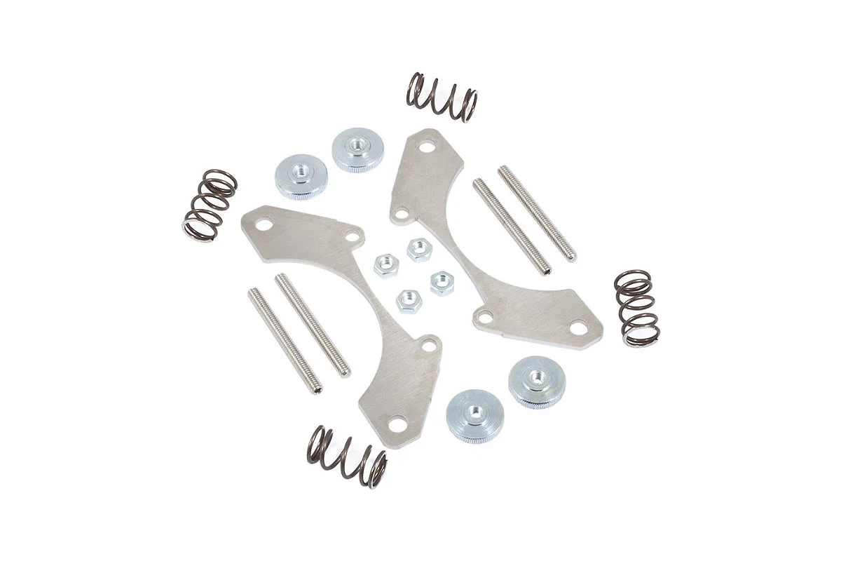

Quick update. The block came and I was quickly able to ID what arms I needed. Turns out they were these ones, as I suspected.
They were £11, so the block has cost me £36 total and should now fit almost anything big. I can order AM4 arms too, so will remember that if I ever change it in the future. The block weighs a ton. It's machined from a solid lump of brass with a copper cold plate. Heaviest block I've ever had.

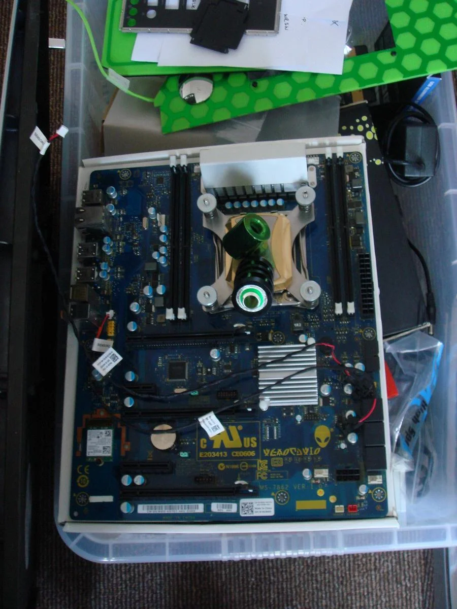

The tear down began last night. It took me about two hours. I removed and plugged off the rad as I didn't want it peeing everywhere and so on. Managed to save the coolant too :)
Then noticed "Houston, we have a problem". Basically the block -
Has the inlet as the lower hole. This is a problem, because the rig is not designed that way. The inlet is at the top and the outlet the bottom :(
Because the tubing is so fat it was close to impossible to change it. So instead I flipped the block upside down. But then it looked stupid, as all of the logo etc was upside down. So I popped out the logo plate, flipped it over and then sanded it to a polished finish before gluing it back in.

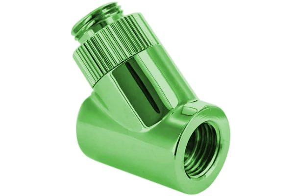

I won't be able to use the green 45s I bought. They hit each other, and even the smaller XSPC so I can't even use one. Harumph. Oh well, it is what it is.

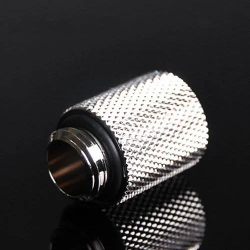

I bought one of these.
It will go into the inlet of the block (top) and then allow me to use my green 45. However, I didn't just do it for that. I remembered that when you screw in both the inlet and outlet you have to do so with it all intact just using the rotary thread part. It's incredibly difficult and fiddly, so spacing it out a bit will make it a lot easier to do.

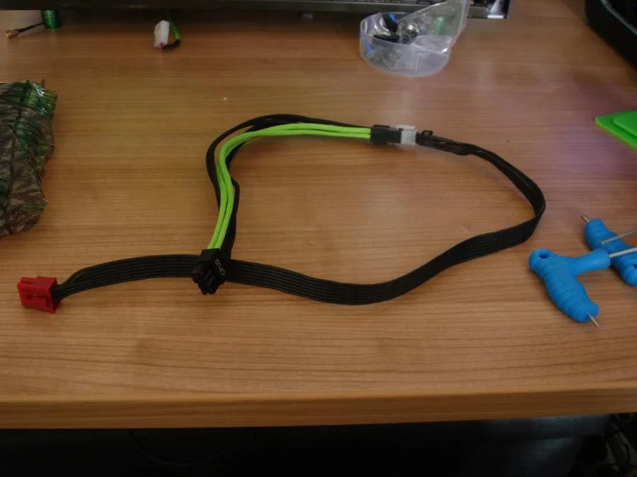

I also remembered the board needs an extra 8 pin EPS for the PCIE lanes (bottom right). What a faff that turned out to be. I went and dug out the box of leftovers but realised the PSU does not even have two EPS. So I took a 8 pin PCIE cable, removed one of the grounds (leaving four) and then split one of the 12v (giving me four). I am not worried about it melting, it's got a GTX 950 on the end FFS. I also made a braided extension with other left over parts. Thank god I had enough plugs.
So that is another pretty savage PITA dealt with.

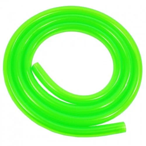

Oh and I also bought 1m hose..
I think I may need a piece or two. Nothing majorly long, just enough to alter the position of the CPU outlet.
