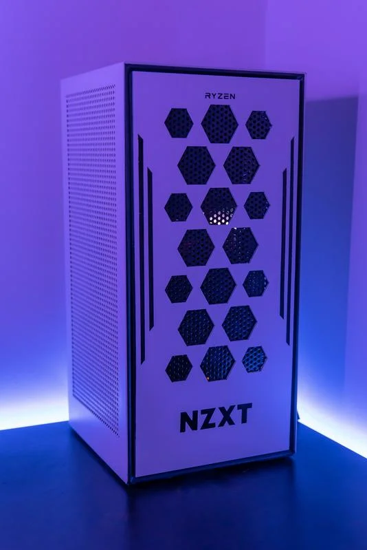

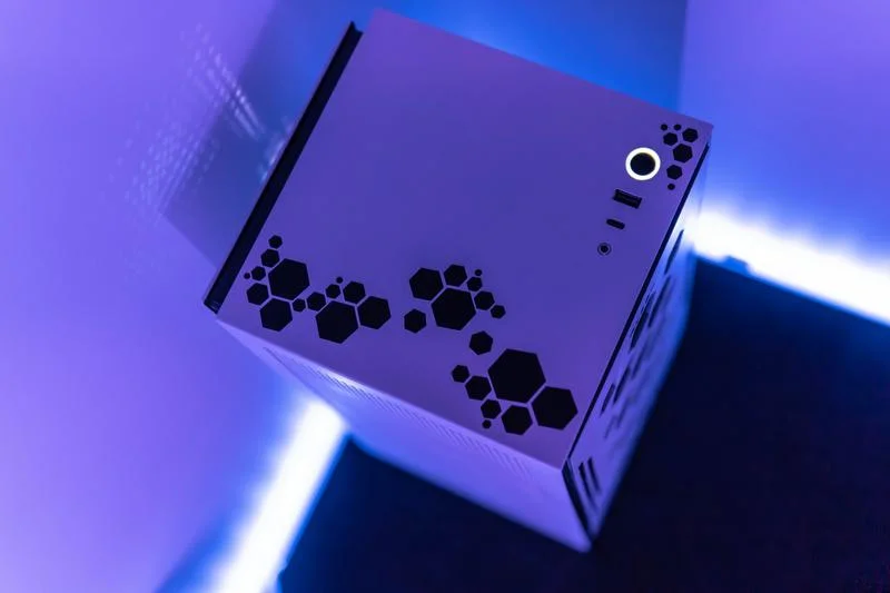

Hi guys, I'm back in London after a long break and managed to finish the build!
I found those two waiting for me, huge thanks to ASUS UK!
Here's some pictures of the final mod, hope you like it! Full gallery here: https://imgur.com/gallery/qeULQoB
