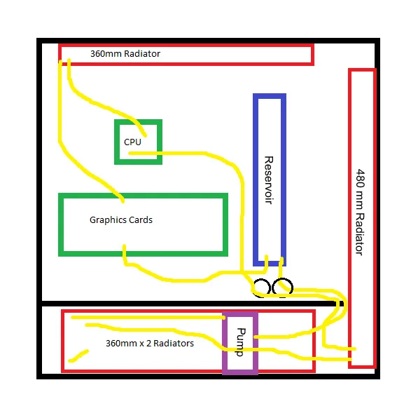

I have therefore made a hasty loop plan in photoshop to help me place the radiators in the correct positions before I get started.
As my Photoshop skills are rubbish then I will explain the idea. The reservoir feeds to the pump which is in the lower bay, the pump goes to one of the 360mm rads which then feeds to the other before going to the 480mm rad. this then goes back up and to the CPU, this then feeds to the top 360mm rad before the graphics cards and back to the reservoir.
Would it make life any easier if you went from one of the 360's up to the graphics, then up to the top 360 and then back down via the CPU?
Could even go res, 480 (large vertical column of water approx. equals res), pump, 360, 360, gpu, top 360, cpu, res. Just trying to reduce some of those long awkward runs - or what appear to be so on the PhotoChop :D

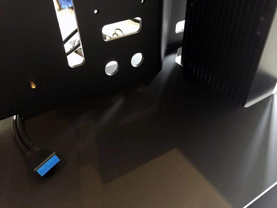

It's only now that I have the case in front of me that I am starting to get a feel for where I can or can't run the tubing. I will need to switch from Acrylic to flexi tubing as I pass through the 2 holes in the back plate before heading down to the lower compartment. I could always drill some holes but would rather work with the case if possible. Now I need to find some good fittings for changing from Acrylic to Flexi in those holes. Will need to give this some thought today. A quick photo from my phone below to show what I am on about. As the front rad is so large it completely blocks the gap at the front which means the only way down to the lower compartment is through the holes at the back.
Just out of interest how are you planning on attaching a fan to the bottom of the 480mm rad?
Also are you planning on using flexi tubing and then fixing a pass through on them holes to switch back to acrylic?
What i did on mine was i was hide the flexi tubing above the rads on the side as the side panel hides it quite well although the tube may be a little tight.
Current plan is for 4 fans on the front of the 480mm rad so that they can been seen spinning slightly from the outside of the case, this pushes the rad right back against the back of the gap at the front.
Currently looking at Acrylic where it is visible and then using some of these https://www.overclockers.co.uk/xspc-g1-4-female-to-female-rotary-fitting-black-chrome-wc-280-xs.html secured in those holes to swap to flexi that will then run down below.
Will likely have to change plans slightly as it develops and I find out exactly what space I do or don't have.
Okay awesome, If you wanted to use pass through i would recommend using these https://www.overclockers.co.uk/bits...s-through-fitting-carbon-black-wc-584-bp.html These are what i put in them holes, its nice and discrete and provides a better finish as you just attach flexi and acrylic fittings to the end. Also them pass through fit perfectly, and do not move at all once fitted.
They look perfect, can't believe I missed them. I take it you need a Female/Female connector for one side to then be able to attach a fitting? A bit hard to see from the photos but looks like they have one female side and a male on the other? Just added a pair to my order to be delivered Monday anyhow.
Nope just a normal fitting don't need any female adaptor just a compression fitting on the side you want to have flexi tubing and a acrylic fitting for the side you want acrylic tubing.
Cheers, just looked at the photos again and can see that the internal thread goes the whole way through. In which case they are ideal, thank you.
You are very welcome, They are a perfect fit, you just ahve to unscreww one side thread it through and screw the other side back on and that holds it in place.
