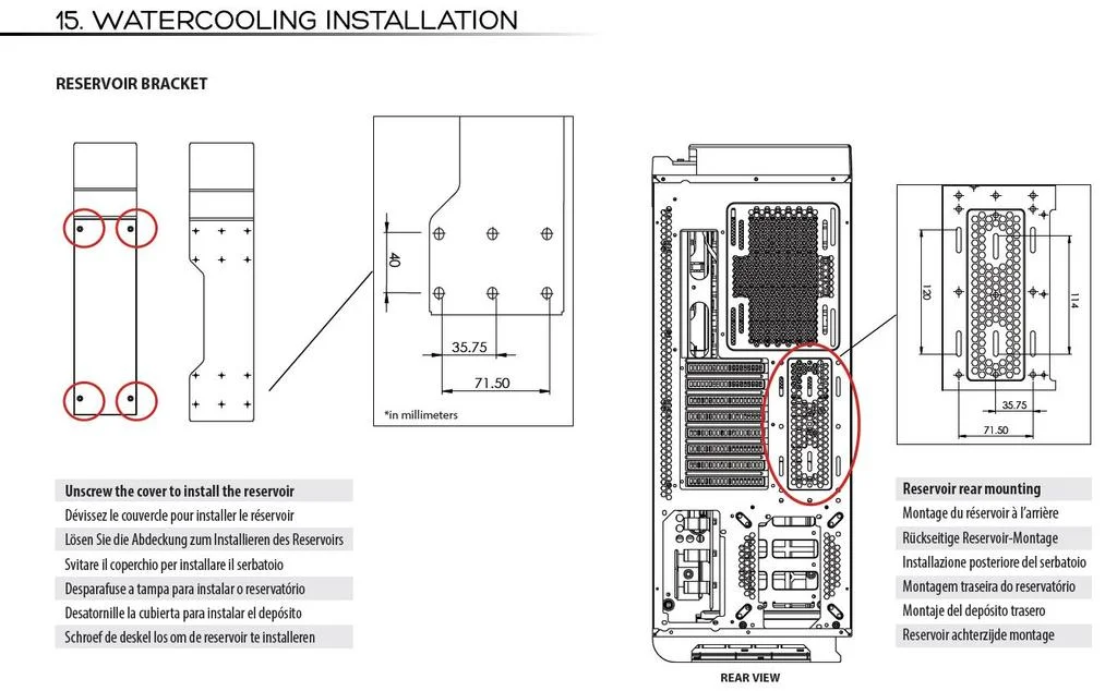

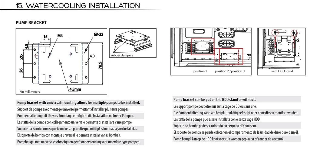

Tube res can be mounted in several places see this from manual.
You could defo get it in behind your rad once you remove hdd bays you then gain access to the pump mount bracket, you get an optional mounting plate. Of course depends on how big a tube you get....
I think unless your card is water cooled (to keep it shorter) it seems to me from looking at pictures that your very limited as a graphics card with aircooler is going to be longer and there is not enough room. I don't have a option to watercool my card at the moment, but as soon as it's available it will be.
I think mounting it at the back will be ok and any res up to around 170mm in height will work (like the XSPC tube) and should not matter (I think) if my card is air or watercooled.
Personally I prefer the EK-RES X3 150mm Reservoir, so that should fit no problem.

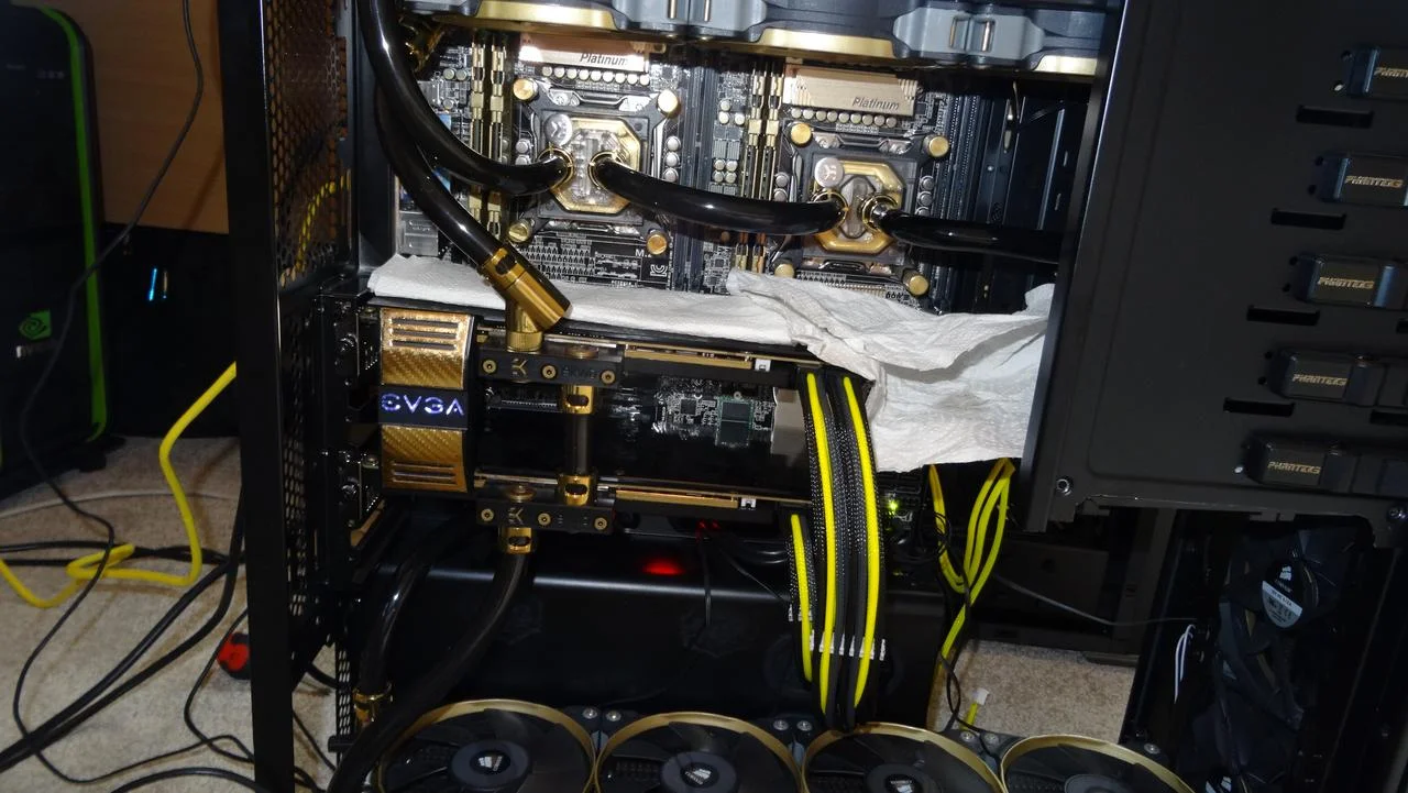

Well after what seems like too long I have Midas running again. Finished my WC loop with soft tubing, the reason being I need to have the machine on for BONIC and Folding and its been sat idle way too long.

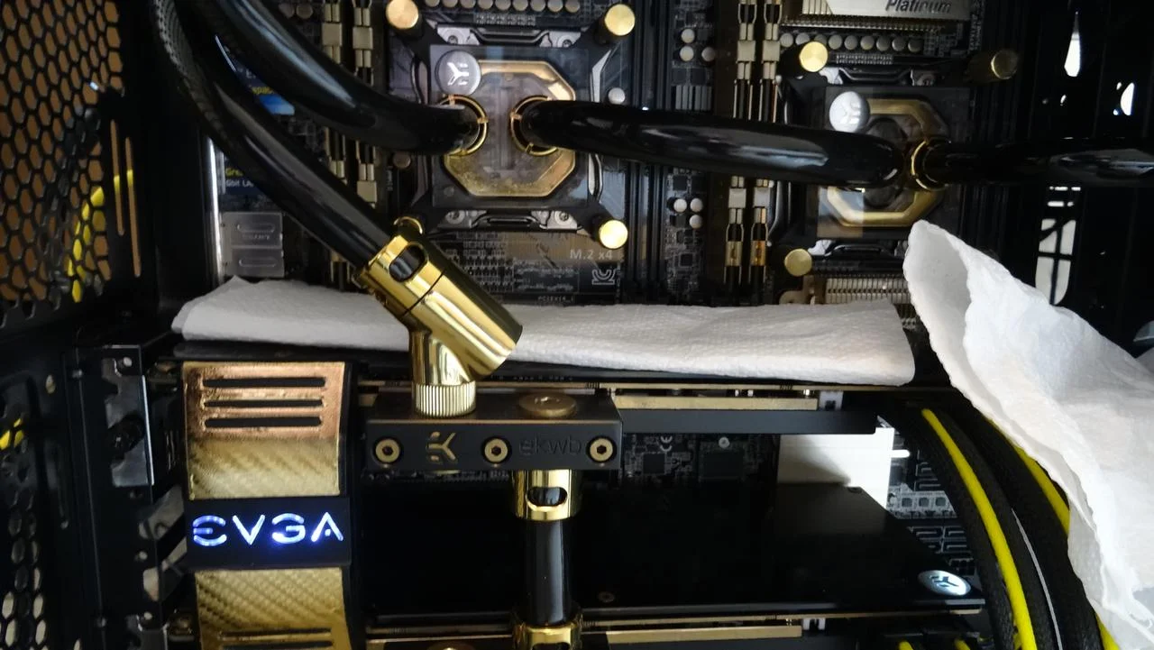

The pipe between CPU1 and CPU2 turned out that both collars were cracked and on first leak test it failed at both ends. I'm disappointed with the Monsoon collars but maybe it was down to my heavy handed engineer approach. I changed it out for soft tubing. So only one pipe in the system is hardline.
The build is untidy but working, this is now going to live in my attic pretty much so no need for looking good, but I'll tidy it a wee bit in time. Its busy doing the DENIS project and Folding@home. CPU temps are 58 degs @ 2.57Ghz both cpu's and GPUs are 48 degs which seemed low given the cpu temps?? Go figure....
The build log is pretty much over I'm afraid, thanks to everyone who followed me but I'm not going to be doing anything else here. Some shots of it during leak testing. Don't worry the air in the cpu's you can see in the pics is now gone, but took a long time to clear.
I will post something if and when I do have a tidy up and fit the other ssd drives. Thanks to everyone who's helped me :D
