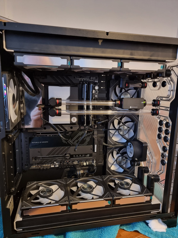

Well here's some pictures, forgive the mess I don't have a lot of space to work

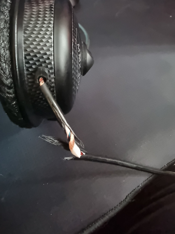

It's a common fault with the Gen1's I have, requires a new cable which is extremely difficult to get and expensive, and needs to be soldered etc. I've had them a good few years and it's funny how you don't appreciate good audio until you don't have it anymore.
@ALXAndy You know a bit about audio equipment mate, don't you? Any recommendations for a new set of headphones, to pair with my GSX Pro Dac? Though I'm tempted to aim for a much higher level of audio for the future

I had a set of beyer T5P. I got them for something stupid like £300 brand new. The head band wore out, the ear cups wore out. Like literally fell apart. I was just about to try and restore them when I made a mistake and blew up both of the Tesla drivers :(
That was a bitter pill to swallow I can tell you.
Thankfully I found a set of ex demo Audioquest Nightowl carbon for about £220. Right at that point my Grado RS2E also died and needed two new drivers :(
Nothing is built to last any more. Which sucks when you spend so much trying to get a high quality item. Those T5P RRP for a grand ffs.

Like I say I had about 5 years out if those MMX300's and loved them. They've been absolutely perfect for me. And if I could get the cable for less than £90 (**** you brexit, £60 postage my ass) find someone to do the soldering,get replacement cushions, and clips for the headband as one side keeps popping, I'd fix them but at that cost I'm at a half decent new headset anyway.
You can get a cable easily. It won't be a BD cable, but that won't be a bad thing. Their cables are pretty junk. Especially the braided ones I had on my T5P. You can get decent cables on the bay of fleas. Soldering them can be tricky as they are coated cables. So need a bit more heat. I managed to completely rebuild my Grados using a cheap pair of Grados. The drivers are the same, cable was thinner (which suited me as the one on the originals was HEFF) and I put the plastic headband on over the original brown leather one as it had soaked up all my bald head sweat and gone all yucky :D

A small bit of progress made with the build, as I desperately needed something to take my mind off of things. I had to wait for an additional push in adapter, and the advice regarding removing the fans solved the issue. The fan to the rear is ever so slightly misaligned though as the heatsink on this board must be larger by a mm or two than others

rear fans not really noticeably out of line
in the photo
shame the 90 degree torque and push fittings dont
also allow the accent rings
looking at the accent rings thinking i should have
gotten those now
the red would have gone nicely with my red cpu block
i wonder if theres any way you could put a red dot or circle
on those black g1/4 plastic blanking caps?

And the horse **** continues with this bloody build! 9 totally dead uni inf fans!!! I just don't understand it at all.
I completed the loop today, I was pleased. Got it filled and powered on. Only the EK distro wasn't lit up and 9 out of 10 of Unifan sl-inf120 fans are dead. Only the rear exhaust spins or lights up! The other 9 are zero signs of life.
I've tried everything, including the heart breaking decision to pull the loop apart again.
So I've tried swapping the fan wires round on the hub.
I've tried swapping the hub twice.
I've tried swapping the cables.
I've tried swapping the fan and rgb headers on the main board.
I've tried other fans on the motherboard headers and they work!
So, I've either got 8 dead ******* fans or I'm missing something? Can anyone help? Please?
