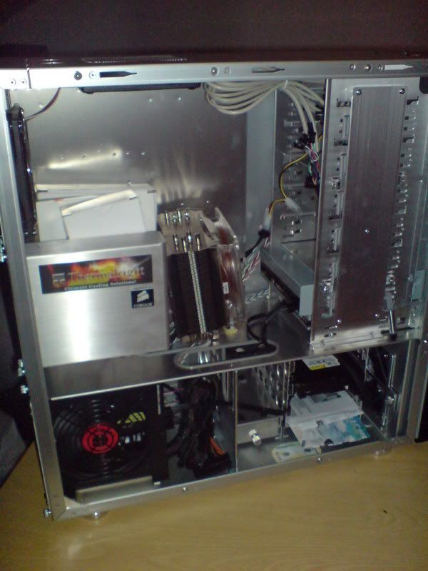

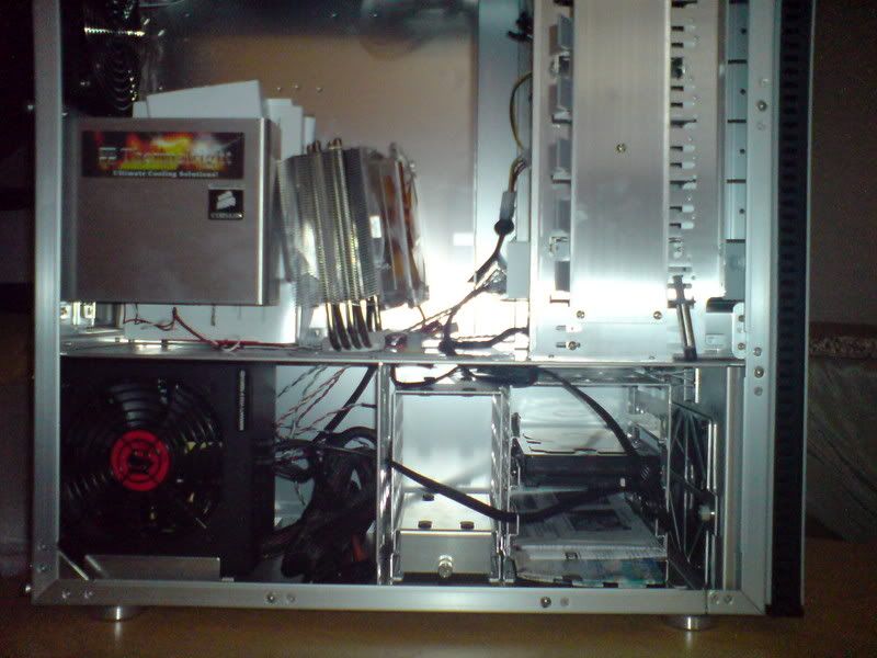

PCI-e and mobo connectors aside, theres 5 general power sockets on the PSU, now ive managed to rig everything up just using two of these sockets,
Socket1... has a 500GB HDD, a DVD-r, and a floppy attached.
Socket2... has 4 x 120mm case fans, with a spare molex for another case fan, not yet fitted.
Is it ok to put all this stuff over two PSU sockets or should I use more cables to spread the load? I was just kind of asuming the PSU would divert the nessesary power to those two outputs?
Ive got plenty of cables so I can use more PSU outputs if nessesary.
Its probably a stupid question, but I thought I should ask anyway....
thanks.
I tend to spread them over different cables. Like one set for HDDs, one set for fans, etc. It's not a bad idea to distribute the load evenly as you can.

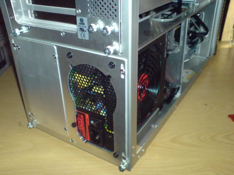

I might have to flip the PSU back plate around, so the fan is facing inwards, as im not comfortable with the PSU fan only having an inch of breathing space against the case side panel.
