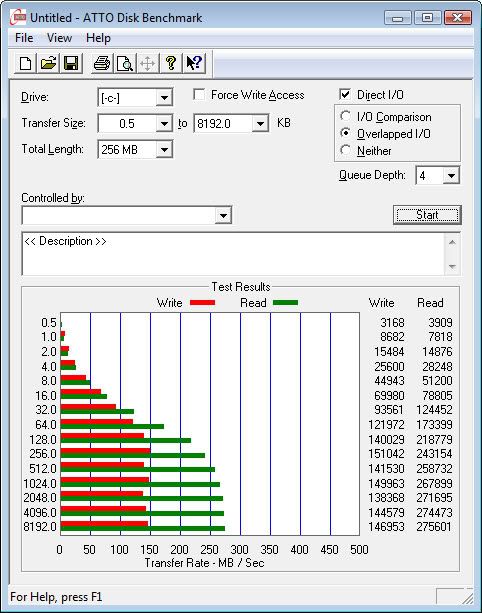

this is the result:
Surveyor
this is the result:

Looks a bit slow for that drive.
Did you set the BIOS to AHCI mode before you installed Windows?
AHCI mode gives the best performance for SSD's.
If you didn't use AHCI mode then you can fix this.
You need to change SATA Mode from IDE to AHCI in the BIOS.
But you can't just do that otherwise your system won't boot.
You need to apply the fix here first.
So first make the changes in the link, restart the PC and go straight into the BIOS, change the SATA mode to AHCI, save the changes and the PC will start again and you'll be using AHCI mode.
Then try the benchmark again.

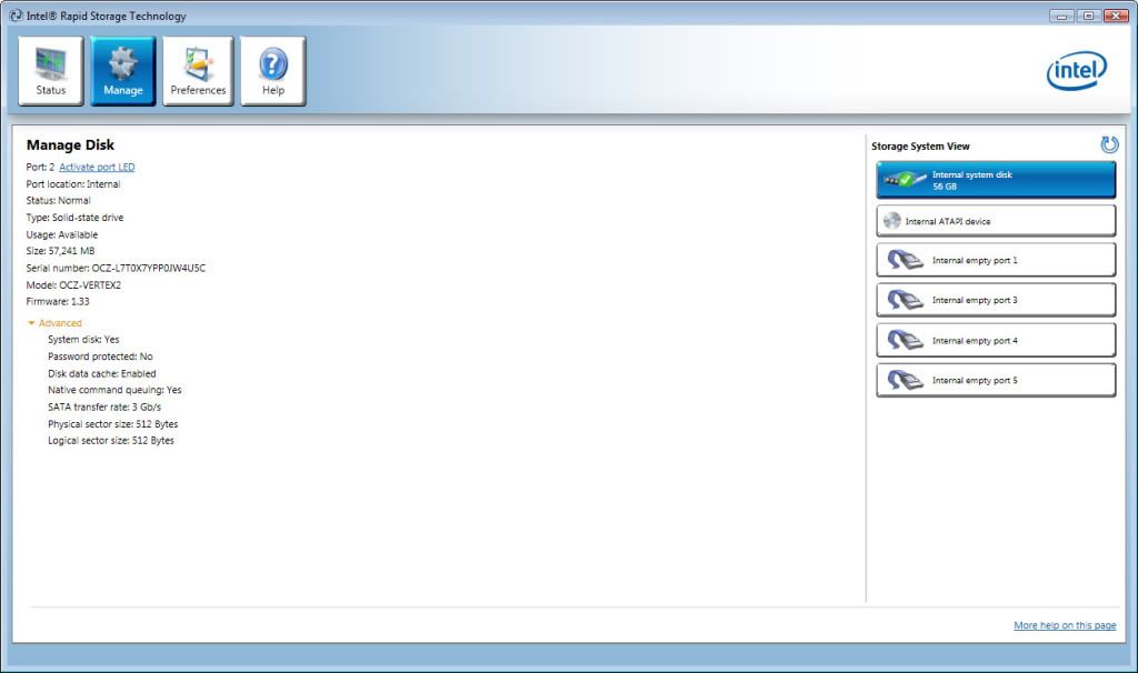

Thanks a million!! I'll be reporting back.
Folks,
It is faster AHCI apparently. When Vista boots, that light green bar that goes from left to right actually runs 3 times and it jumps to the logon screen which is faster than before many times.
I also tried that 3.73GB copy from USB, this time the speed is 34MB/s, not much but at least a several MB improvement.
