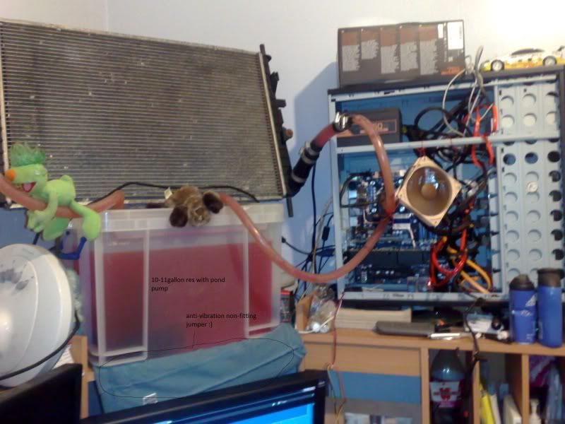

well, she is one one peice, although not filled in this picture, she is now full. not run the pumps yet as its bloody 4am and i wanna sleep
spot the error, copper block, thats a copper cored rad
then i went and put bloody ally reducer blocks in it
oops. will this mix corrode the copper or just the ally, if its only the ally i dont mind as its about 8mm thick
