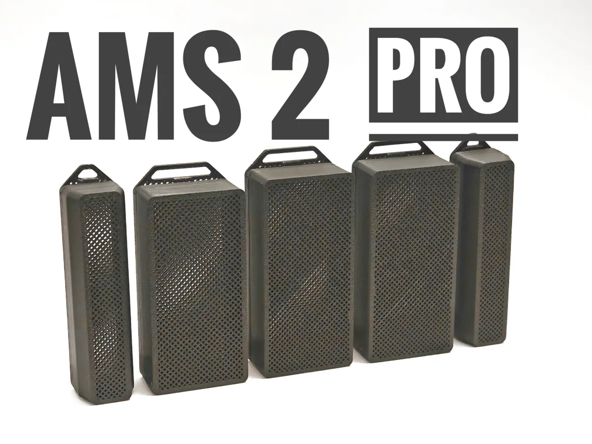

I'm looking to print a couple of accessories for the internal bits of my P2S. I want to start with some dessicant holders for the ams 2 pro and then an internal fan modifier to even the air flow internally. I'm thinking I'll print with ABS so I can continue to use the filament dryer function for pla and petg without worry of deformation etc. What's the best model on maker world people have used for the ams 2 pro? Quite a few options so would be interested in opinions here.
Lastly are there any other useful items for the printer I should consider whilst I have the ABS filament loaded?
I used these and doubled them up. I printed them out of PETG and so far so good but I haven't used the AMS for drying yet.
Honestly I've spent ages on the Bambu forums and facebook groups and I would avoid printing anything for the inside, from what I have seen they generally cause more harm then good. Bambu know what they're doing and all you're likely to do is introduce potential issues, desiccant holder in the AMS is obviously a non issue though.

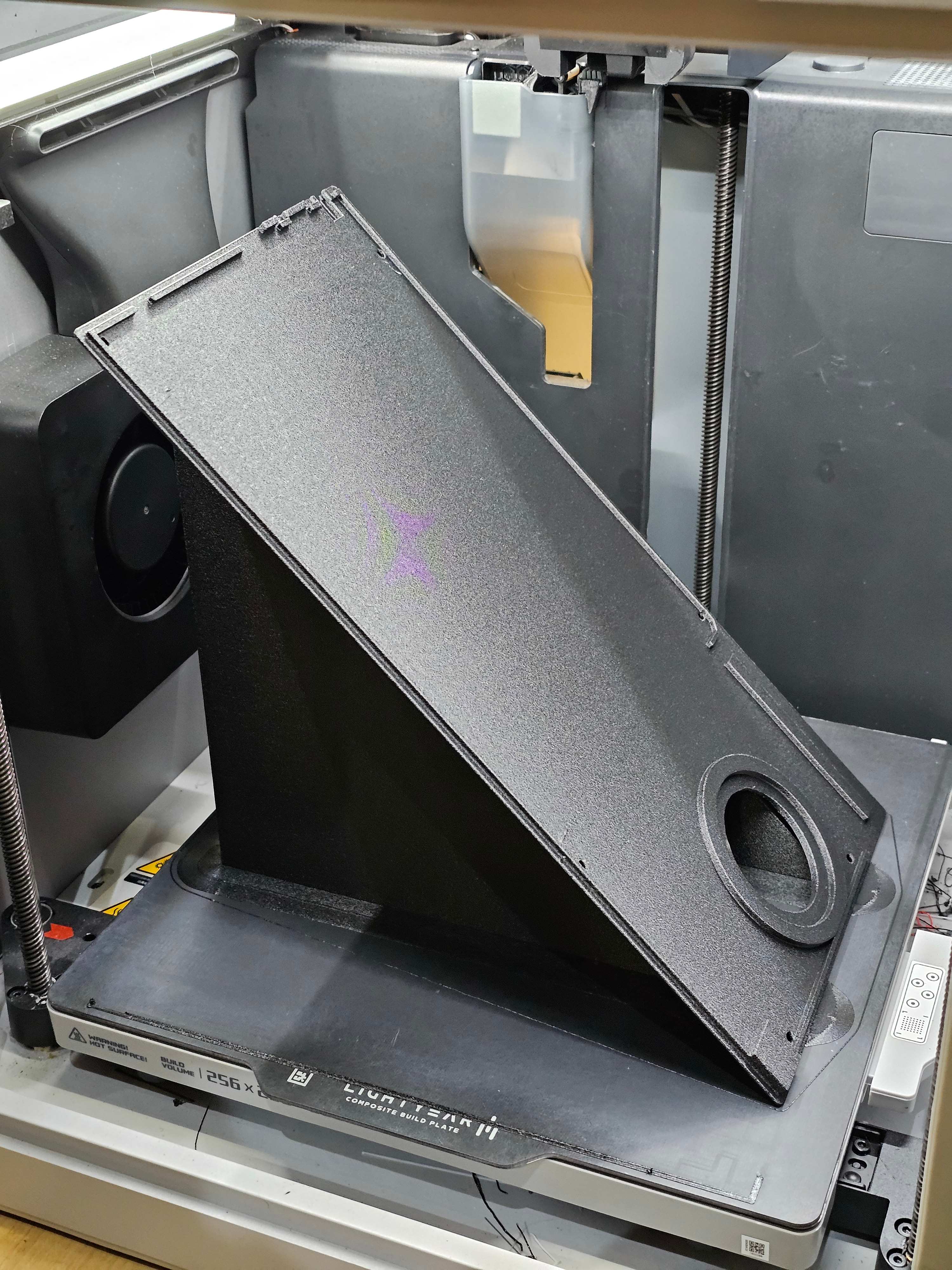

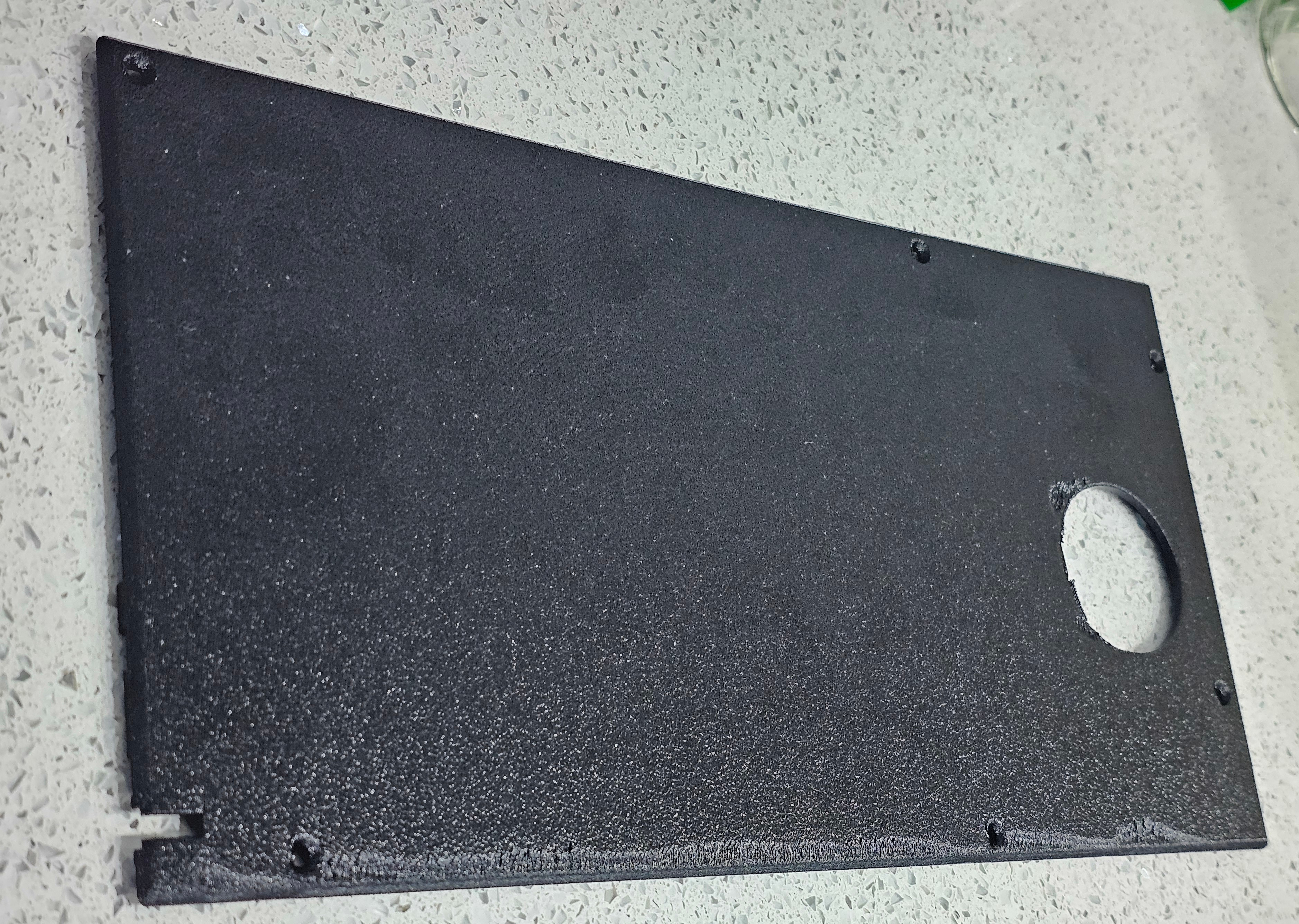

How do you print a 308mm long part on a bed that's 256x256? Easy, you follow Clough42's guide and improvement. These are based on a tip by Slant3D but do go into more detail.
James (Clough42) did his so that various features would have layer lines at more advantageous angles. I've done mine on a much larger part....to see if I could! :D
Top surface looks great, despite me thinking that I should have put some support under the top of the hole (foreshadowing!)
The underside...not so much. Not sure if I needed to have one of the supports nearer that edge or spin the whole lot by 180 degrees so I could get the aux fan blowing on that surface. I do have the layer fan that's known to be too weak and cause trouble on overhangs so it could be too little cooling. Would be interested in if anyone has had this sort of defect, what fixed it.
I don't think it's really stiff enough like this for this particular part (3mm thick for the majority of it) but could work for thicker stuff - no marks left and it didn't fall over! I may be able to go back to a two-piece print with Slant3D's diamond pins (or something else) to join them. If I put the joins at different ends and then screw together (it's a case and this is the lid) it might be stiff enough and stay together enough to work. Anyway, thought it might be interesting. The supports came out lovely! :rolleyes:
