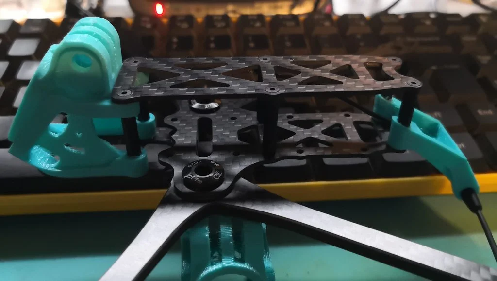

Update.
Cr-6 SE arrived on Thursday, all I can say is wow what a printer for the price, huge upgrade from my 6+ year old Wanhao duplicator.
This is so easy to use, level the bed via the menu and you're good, simple as that.
TPU first prints with it for a new quad.
I'm just using the Creality Slicer that it came with.
