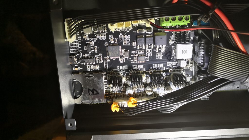

Decided to check over the 6SE after 30 hours of print time and have a good look around it internally.
Everything was good, could see the switch reported issue, 6A switch with 16A spade connectors to it.
Decided to bypass the switch and remove it, I will get something more suitable, easy to do just remove one cable and connect it directly to the main socket after removing the switch wire from that post.
Nice to see everything hot glued down to lock in place on the main board.
Pics of the board,
I'll add a direct link at the bottom of this post to access the full size pic.
https://i.imgur.com/cRCOPeR.jpg

Thanks for the pics.
I will bypass mine when I get it.
