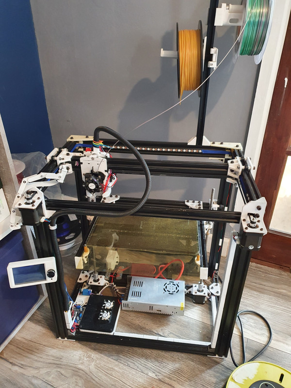

Check her out. Now sporting a pi cam and everything.. i have more upgrades to fit (2209's) and some other bits but for now she is working well!!
Very nice. Articulated Pi cam no less!
Have you never had trouble with bits of filament - like the angel hair stuff you get sometimes when it oozes in travel or priming - sucked into those fans? I've had it happen a couple of times to my hotend fan and it's a right pain as you have to shut everything down to stop the fan and pull it out with tweezers.
