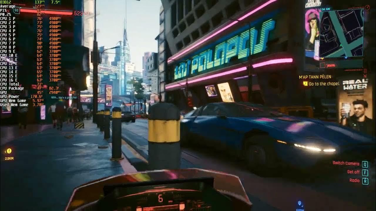

My 13900k (with Strix 4090 @ 70/% PL 350W)
Another user's 13900k in similar area
145-175w is the consistent power draw of a 13900k with 4090 in Cyberpunk, with 4K RT enabled, all ultra. Spikes to 220W do happen, though are not consistent.
My 7950X3D draws 60-70W in the same game.
