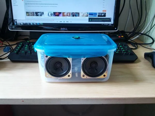

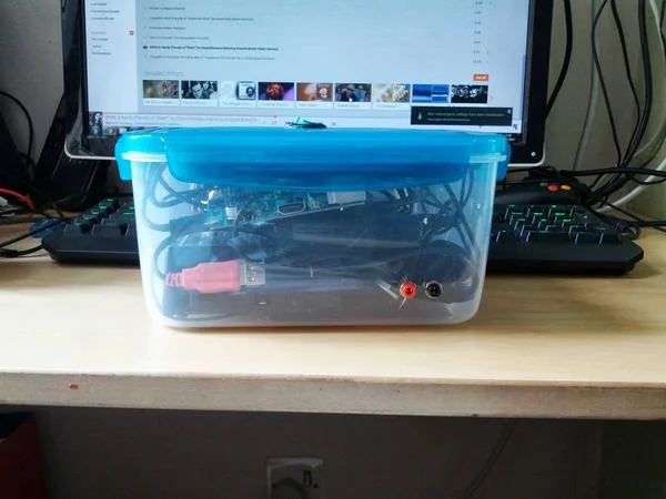

Had a Pi since they first came out and mines been mostly running Raspbmc, but I decided to get a second one for a project.

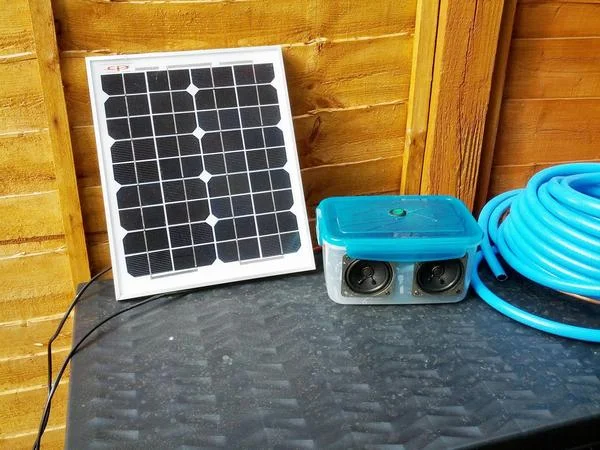

Inspired by seeing someone else's project of using it as a pair of AirPlay speakers, I've decided to do the same but make it more portable. Currently how it is setup is that the Pi will boot into Debian and then act as a wireless hotspot so you can connect to it and then stream music from your device to it.
It draws power from a 12000mAh battery pack, which in turn can either be charged via a standard wall socket or also by a solar panel which I've purchased. The solar panel is external to the rest of the setup so I'm using some 2mm plugs to make it easier to attach when outside. The battery pack also has a secondary output socket, which will be connected to a USB-A female port which you can then plug your phone into to also charge it up. The speakers are USB powered so they just draw power from the battery pack.
I tested the battery pack to see how long it would play for without any external charge and it went for 7 hours continuously playing music before cutting out, which doesn't seem to bad. The solar panel charge rate was also tested in a basic fashion and put around 75% of charge into the battery in 5 hours-ish.
Started the soldering tonight but mostly having an issue with cutting a hole in the chosen temporary container (a plastic lunch box).
I'll post some pictures of the monstrosity once I've got it in a more complete state than it currently is!
