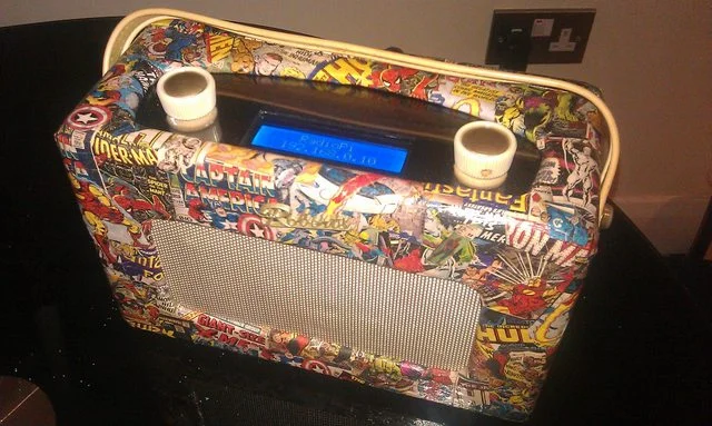

Just finished revamping a 1961 Roberts radio to be a squeezebox powered by a Pi. It features an Adafruit LCD and two rotary encoders for volume and menu selection.
It was a great project for learning Python and many other random bits and pieces :)
Full project log available at http://plentyofgin.blogspot.co.uk
