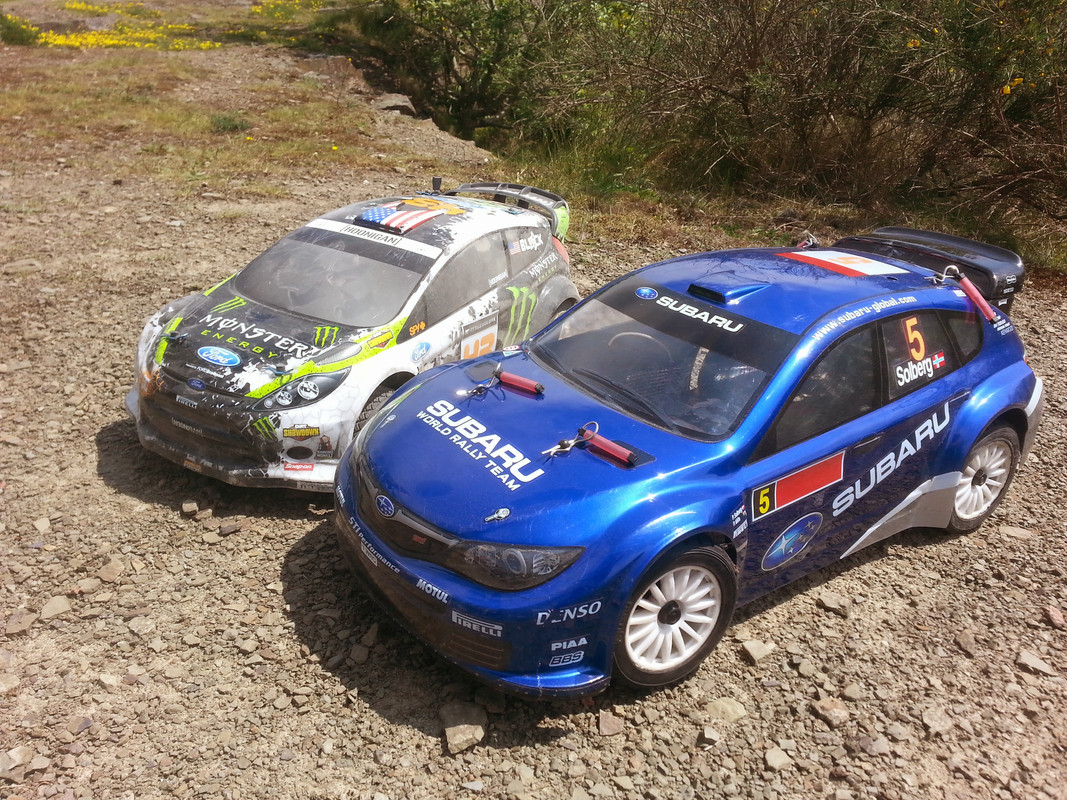

Which body? I have a Hyper7 and didn't think the dimensions were right for a rally car.
You can do this!
I got a deltaplastic 2mm subaru shell. You will need to buy a front and rear shell mount kit, about £6.
