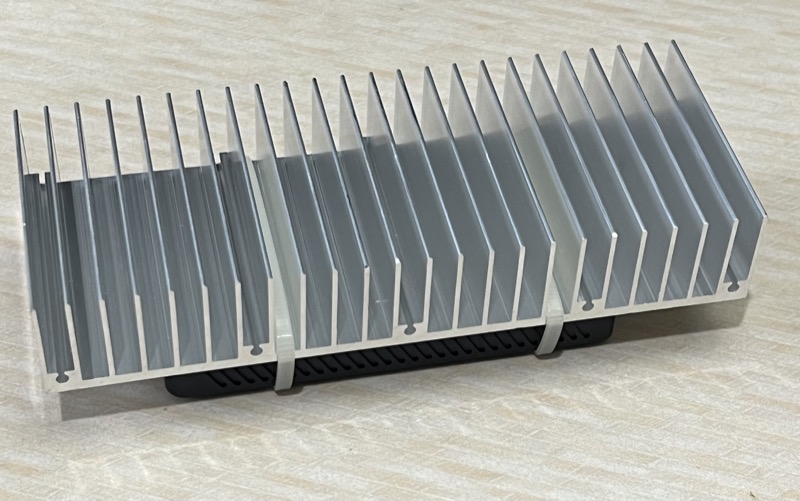

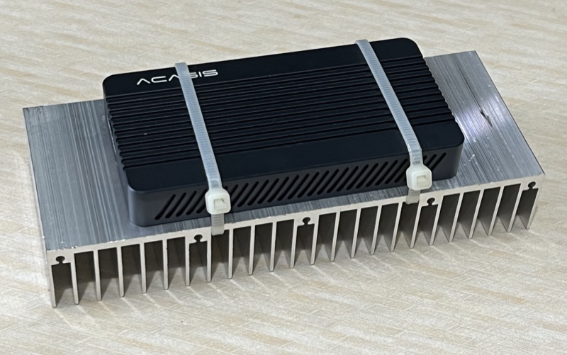

No fan on mine but I fitted a huge heatsink. It's actually underneath my desk so totally invisible and it stays barely above room temperature.
Do you have a IR temperature sensor gun then to see the temperature without that massive heating.
The UGreen has a fan, good for cooling but add noise, passive would be preferred but depends on heat.
Yes.
But that was well over a year ago, I have no idea what it was before other than hot.
And now it's barely above room temperature and it's utterly silent.
Yes.
So the stock enclosure is inadequate.
What is the exact dimension of the enclosure? If I were to do this, I want a heatsink closer to the size of the unit.
No, I monitored the SSD temperature and it was within spec but I prefer to keep things cool.
1.9" x 3.9" x 0.55", according to the place I bought it. I'm not at home so can't measure it.
The heatsink is 150mm x 59mm x 25mm.
So 48mm x 99mm.
This is 24mm x 79mm, put 2 of them side by side...:D
