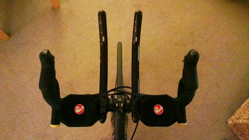

Unsure where to mount these aero bars. Read that it's better to start with them towards the outside to get used to them/for balance etc, but just tried to mount them over my bar tape and whilst they fit they restricted the gear cables so I couldn't change within a few (fortunately they work since I removed them so no damage).
Any further in and I can't see how I can get them under my cables, and they didn't come with rubber pads so they'll scratch the crap out of my bars (yes yes, more than they are already...).
Dont put them over the top of the bar tape. Mount them somewhere on the bare bar near the middle (not outwards of the point where they start to taper). Use some electrical tape or something to stop your bars getting scratched.
Not the help you're looking for... But your wheel looks crooked, like it's off to the left.
I thought that. What would be the cause and fix?
Will do. Just went to buy some different bolts from Toolstation and the chap was extremely helpful, suggested using an old inner tube cut up to put under the clamps. Thought that was very clever!

Stem slightly off centre. Loosen the stem, line up the stem with the wheel, tighten stem. You might want to get it so it's tight-ish but still pliable so it doesn't just flop about all over the place when you're lining it up.
This.
Make sure that you tighten the top bolt before you do up the stem bolts.
