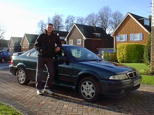

Hi there. Welcome to 2002. Had my 2.0 4 and a half years. Also best mate had a 1.8vvc. Admittadely I'm not a mechanic, but I've spent plenty of time under the bonnet and I feel my opinion on the car is as valid as any.
