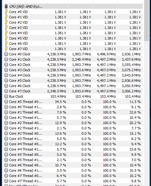

Just tried bclk 101, to see what would happen, and it seems to work just fine. Slight performances increase overall and max boost frequency achieved is now 4392.9Mhz.
Note that this is still with the -0.05 Vcore offset applied.
I got pretty much exactly the same result, -0.05 and 101 bclk. Max 4392 on some cores.
Some interesting results here, 4497 single core boost. Unsure why voltage is locked.....
