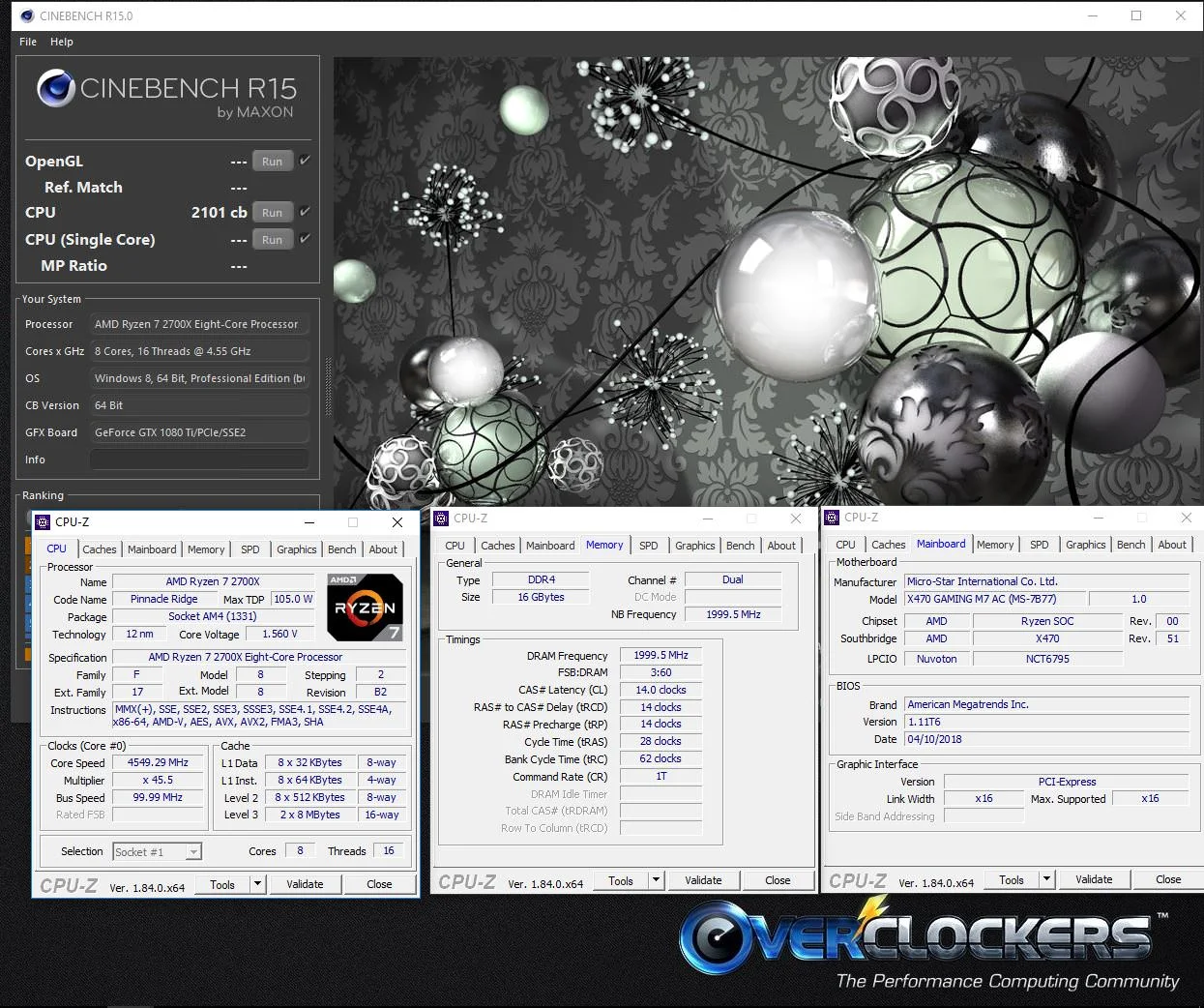

Been messing with my 2700x today and found i could do 101 bclk but anything else locked all cores to 3.7xx depending what i put the bclk at. Tried the -0.05 offset but got worse performance in Cinebench, max single core was still 4392 but all core dropped from 4014 to 3988 and multi score dropped from 1834 to 1822.
My 2700x will sit at 4014 on all cores until it hits 55°C and then drops to 3988.
