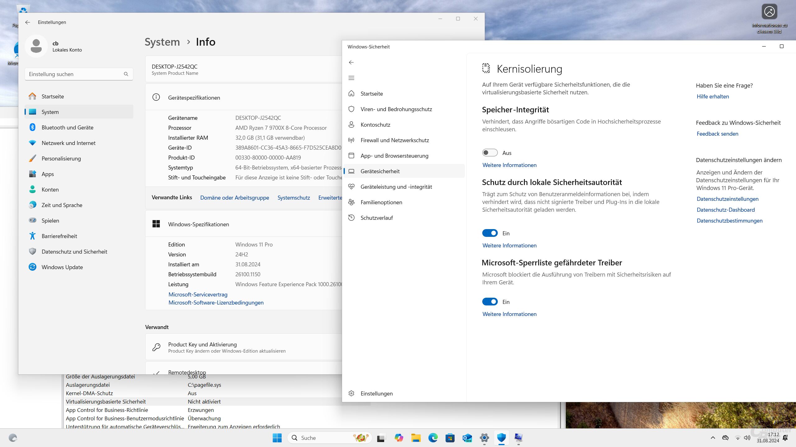

You need to enable virtualisation in the BIOS if it's not enabled already.Memory Integrity is missing from mine.
I thought that these various security patches / options were forced by Windows to patch Intel's spectre / meltdown problems. Not needed by AMD users but hey Wintel is Wintel after allMemory Integrity is missing from mine.
I have tpmf or whatever its called turned off in the BIOS, is that why?You need to enable virtualisation in the BIOS if it's not enabled already.
I don't have LSA Protection, perhaps only newer CPUs have that functionality.
Are you using Intel or AMD? It's SVM for AMD and I believe it's VT-x for Intel.I have tpmf or whatever its called turned off in the BIOS, is that why?
fTPM is AMD and generally disabled to stop some game stuttering but this is needed to install Win 11 though can be disabled again after install.Are you using Intel or AMD? It's SVM for AMD and I believe it's VT-x for Intel.
I would enable the TPM if that's what that tpmf setting is (if you don't have a discrete TPM that is).
The fTPM stuttering on AM4 was supposedly fixed from AGESA version 1.2.0.7 and later.fTPM is AMD and generally disabled to stop some game stuttering but this is needed to install Win 11 though can be disabled again after install.
I think it's this, interesting:One thing that i did find, type "features" in to the search bar, you know what this is? It was enabled for me....
fTPM stuttering has been fixed in newer BIOSes on AM4 according to AMD (AGESA 1.2.0.7 and later).This ^^^
I'll look for that in the BIOS later thanks...
