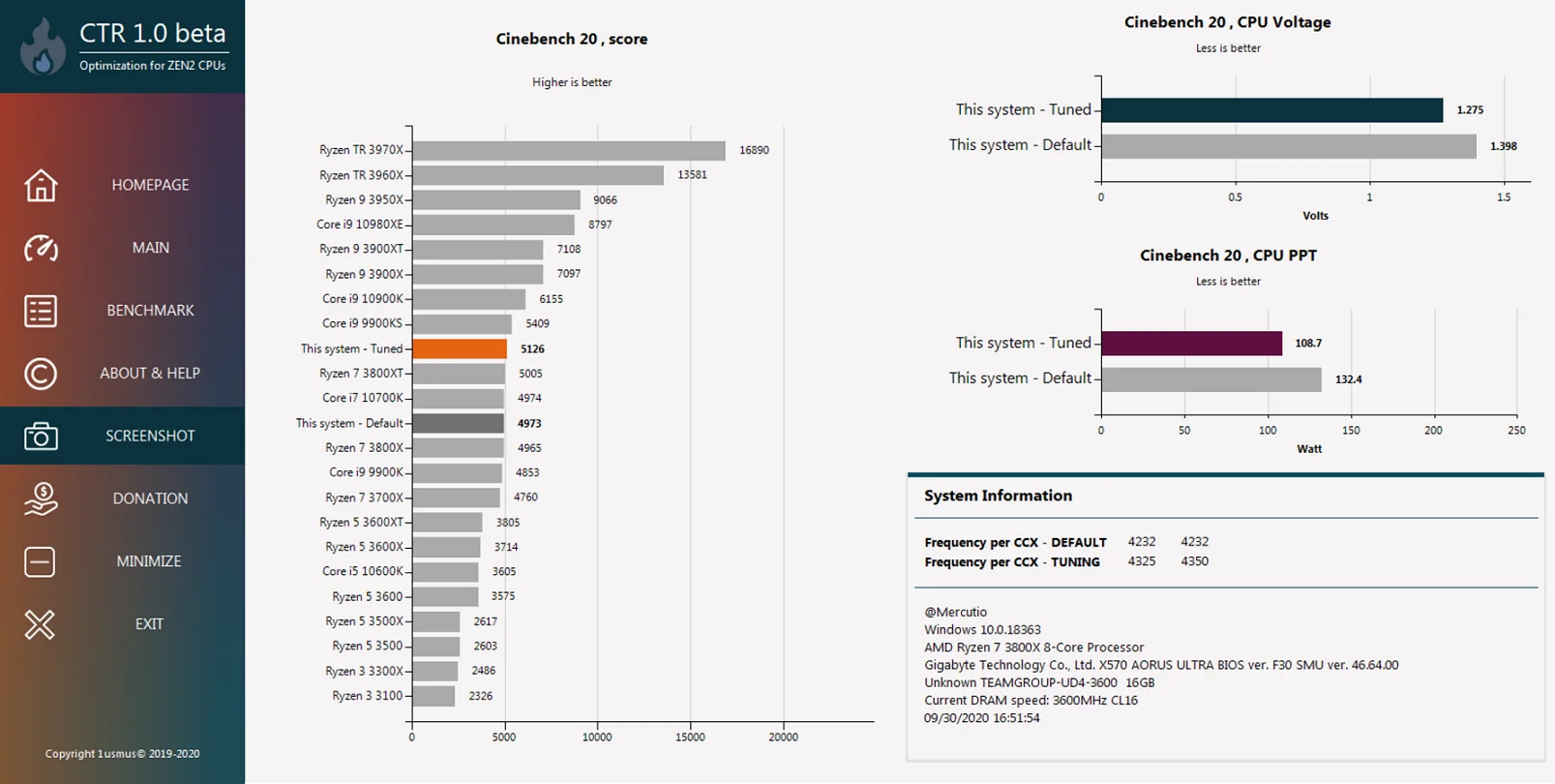

so far soo good great app. i have R5 3600 silver plate all cores 4225mhz at 1.275v good for gaming and general pc use. cpu temps went down maybe 7- 10dregrees happy with it overall. Will see in long run how it goes

dont know but my 3Dmark Port Royal score went up with this all core boost from 11181 to 11431. Previous score is stock boost . I know its synthetic benchmark not real game
Well... running this between completely untuned yesterday and today on timespy (yes, still synthetic but...) my CPU dropped from 10222 to 9806.
Frequency is clearly lower too 4.549mhz down to 4.341 (which... makes sense with the above tuning).
It's obviously going to change a good bit from game to game (or game benchmark to game benchmark) depending how well the engine uses it multithreading but... yeah, I think I'm headed back to defaults with PBO.
Awesome tool for those wanting all core though. No doubt on that.
