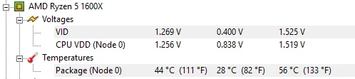

But yeah I get what you mean about "weird voltages"... this is mine while gaming, stock with a small negative offset, all cores at 3.7ghz:
To be fair, I've never seen it reading above 1.5, and 1.4+ is usually in bursts of maybe 1-3 seconds and tied to one-core boost. Clearly those big spikes are very short and infrequent. It's possible that it's just a whole new paradigm on voltage use that nobody quite understands yet. What would really help is a statement from AMD giving not only the "safe 24-7" voltages, but the absolute peak XFR that they would expect to see. It's probably something higher than any of us expect and we're all worrying needlessly :)

well if you go by the VID amd thinks 1.269-1.525V is what is required for the chip to run at stock (your screenshot) so maybe their no issue. but when AMD say 1.45V reduce lifespan it doesnt make semse...
when the AMD profile sits my chip at 1.488V 24/7... (stock)

That is exactly my problem. Ryzens exceed what AMD recommended at stock... would love to see them publish an article that explains it in unambiguous terms. The enthusiast crowd is too determined to peek under the bonnet to not be clued up.
*edit* Also, the VID changes on a whim anyway... and my VDD has now caught it up - though not exceeded.
