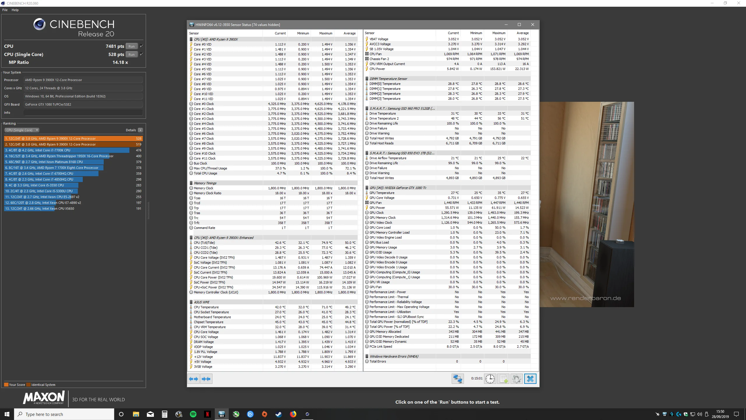

https://i.~ibb.co~/rwwvF1H/2019-09-30-21-03-05.jpg
https://i.~ibb.co~/C7C900V/2019-09-30-21-04-29.jpg
https://i.~ibb.co~/pJvkfft/2019-09-30-21-04-39.jpg
https://i.~ibb.co~/GppCQxs/2019-09-30-21-05-57.jpg
https://i.~ibb.co~/sPCfXFq/2019-09-30-21-21-38.jpg
https://i.~ibb.co~/HKgFsPw/2019-09-30-21-22-48.jpg
https://i.~ibb.co~/pyhf9kT/2019-09-30-21-22-50.jpg
https://i.~ibb.co~/4KvfCHs/2019-09-30-21-31-11.jpg
https://i.~ibb.co~/x7HSx2S/2019-09-30-21-31-13.jpg

4. See my screenshot below and this thread: https://forums.overclockers.co.uk/threads/ryzen-3900x-thread.18861505/

ok did some testing last night, seems that from the AMD blog post everything on my system is working "as expected"
AMD Source: https://community.amd.com/community...te-5-let-s-talk-clocks-voltages-and-destiny-2
Im seeing in Windows at least at idle voltages around 1.0-1.2v, under load 1.3-1.45v which as per the AMD offical report is to be expected.
What is intresting though is once i enter the BIOS the CPU voltage permently sits at 1.4v as per the screenshot below, i presume they havnt fixed the BIOS yet and only Windows is corrected (with their AMD power scheme and Ryzen master)
In my testing i was hitting around 6900-7000 on R20 Cinebench.
AMD reports that if you have system tray applications such as Steam, Corsair iCue this can effect the CPU voltages. This is infact true, with iCue & Steam running my CPU was sitting around 1.3v even though no cores are under load, when i exit stright away they drop to 1.0-1.2v.

https://i.~ibb.co~/HKZKj2C/2019-10-01-18-38-47.jpg
https://i.~ibb.co~/hYKKy1g/2019-10-01-19-14-58.jpg
https://i.~ibb.co~/ZxdmBJX/2019-10-01-19-15-45.jpg
https://i.~ibb.co~/8YYXLLd/2019-10-01-19-33-50.jpg
https://i.~ibb.co~/k87gFNs/2019-10-01-19-34-09.jpg

You can largely ignore the vcore voltage reported when in the BIOS, it'll be similar for all motherboards and there's not much load so 1.4v isn't an issue. I don't know what state the microcode/BIOS puts the CPU in for the BIOS but it certainly shouldn't be compared to when running an OS.
Ryzen's boosting algo is very sensitive but also some applications poll the hardware sensors too often/hard and/or are written without Ryzen's boosting in mind. However, sitting at 1.3v all day (though it won't be the case for all cores i'm sure) is fine for something that is "basically" idle as it won't be drawing much power.
