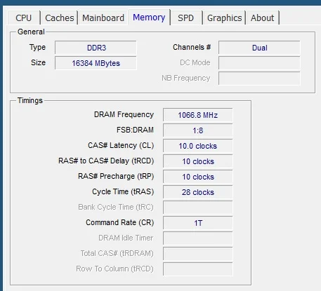

Ok 8Pack it arrived.
I have it runnuing at 2133 @1.5v. Everything else is on auto voltage wise. So pll is 1.8, VCCIO is at 1.050v.
Here is my cpu-z.
What tests/benchmarks should i run to ensure its running at optimum speed and not losing performance?
