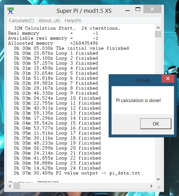

not gonna be much help to you i'm afraid as i'm not on sammy's, mines running 10-12-11-31 1T @2.4
just posted pic so you have a gauge, i should imagine once you have them sorted, 7m 30s as a rough guide for yours
Does cpu speed make a difference? I'm only at 4.5ghz. Ah so you're at 2400mhz? That would explain your quicker times. I will post back with a result shortly.

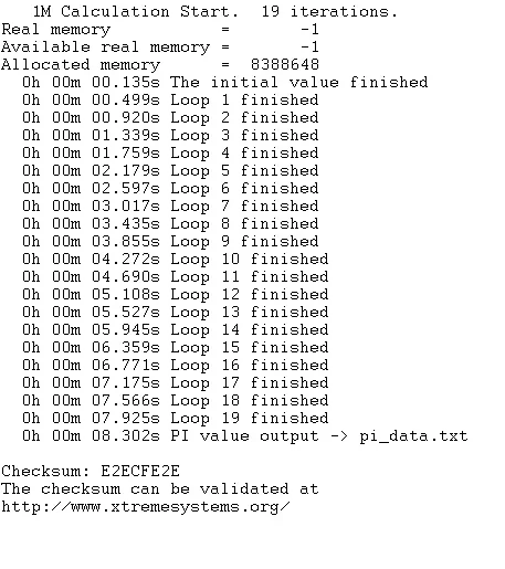

Yes Matt, CPU speed will make a difference to the Super PI score.
For reference to your 1M run, I managed this with my 2500K.
