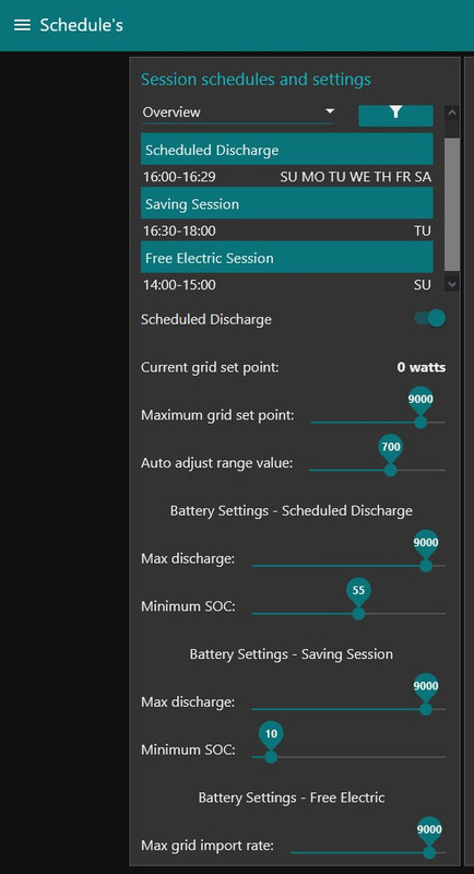

Just about to modify my Node Red so I can schedule saving sessions, and scheduled discharges, looks like I may need to add "Free electricity sessions" as well to the scheduler.
Updated my scheduling system for saving sessions, and the elusive free electric sessions. Schedules and settings can all be changed on my phone/tablet/PC.
