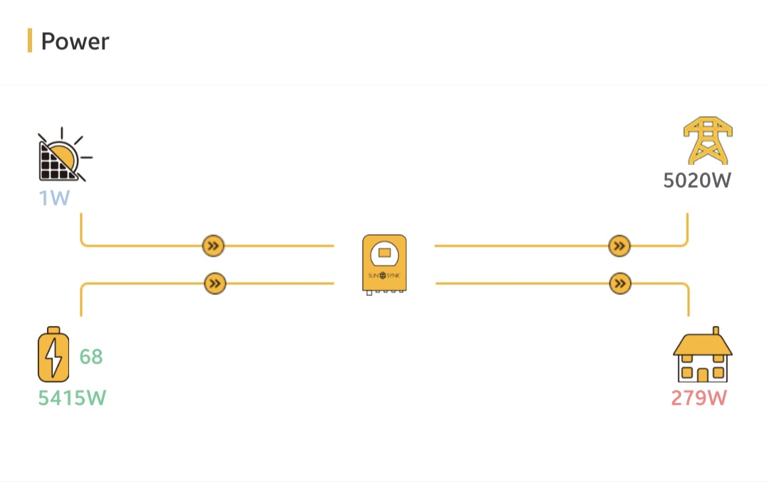

First saving session and it appears the Sunsynk app is showing incorrect figures.
Sunsynk Connect shows export to the grid at around 5025W.
But the in home display for the smart meter is reading around 4.5kW

The inverter will be outputting at a max of 5000w AC (if its 5kW) but then there's your house load from that.
On mine it's taking 5.2kW from the batteries, outputting 5kW AC and the export is 4.62kW.
The flow chart is saying I'm exporting to the grid at 5kW.
My IHD shows 4.55kW right now

Likely efficiency losses in the mix as well.
My battery shows 9.3 kW discharge, house load 430w, DC system 400w and export 7.8kW, which of course doesn't add up, it's about 1kW out.
