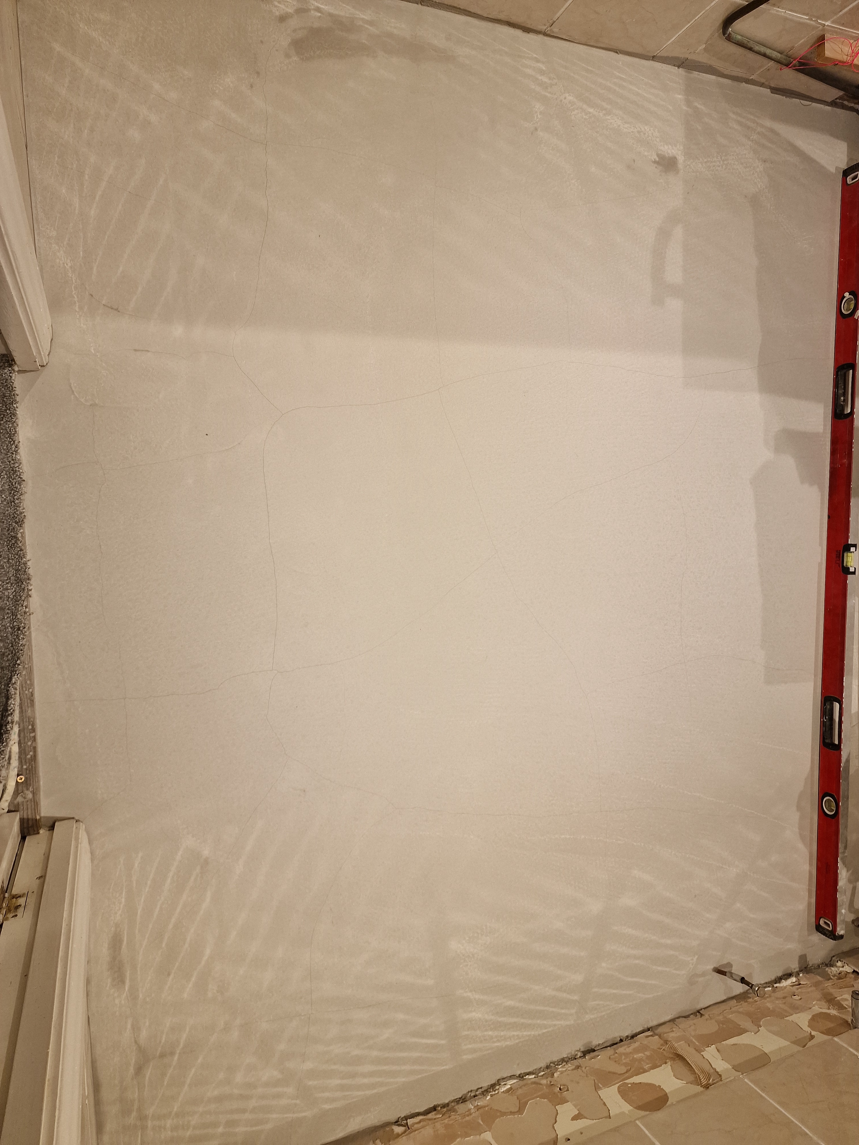

Recently poured self leveling on bathroom floor and it is cracking. will I be ok to lay tiles on this or will it need to come up ?
Floor is
18mm plywood
6mm insulated cement board
primed, then lay electric UF heating mat
6mm(ish) of self leveling
at this stage some of the heating elements had come unstuck and risen to the top of the screed.
So i dug out the worts affected areas and secured them to the floor then covered with tile adhesive
then primed again and repoured 3mm of self levelling over the top of the existing
now it is cracking. see pictures below
Firstly is the product used suitable for a 3mm layer?
Secondly if the answer to the first is yes, did you ensure the subfloor was perfectly stable, completely screwed down etc?
It's no nonsense slc from screwfix says 1 to 10mm.
Plywood was screwed down and the cement boards were screwed down to that as well. Used plenty of screws.
I could hear the floor cracking when I walk on it. Not so much now though.

Yeh I did use primer, maybe I didn't use enough or the wrong type? It was the stuff that came with the uf heating.
I have tapped on it and I don't think it's loose.
One thing that could have had an effect the main central heating pipes run under this floor so that could have dried the floor out too quick. I did wet the floor before pouring the 2nd layer as well just to try and help with it potentially drying out too quick.
I did notice a bit of cracking on the first layer as well but it wasn't as bad.

The 6mm ply will have some flex in it surely even with screws, probably enough to cause the cracks
