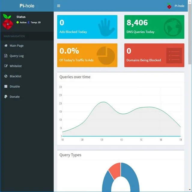

Hummmmm. Not having much success with this.
I've installed it on my Pi and i have the IP set as the DNS server in my router. My devices show this as the DNS server correctly, so the settings have fed through.
However, it is blocking no ads. What am I missing?
From the Admin page:
7,331 DNS queries today
0 Ads blocked today

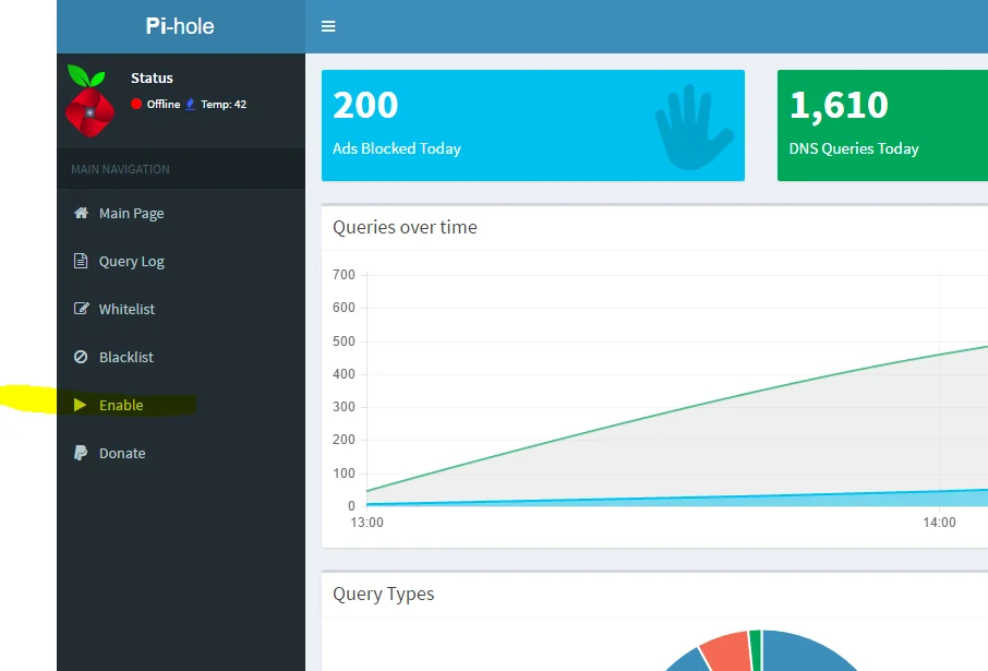

If you log into Pi-Hole, what does it say on the left?
If it says 'Enable' like this, then you currently have it Off
Click Enable.
Status in top left should change to 'Active'
