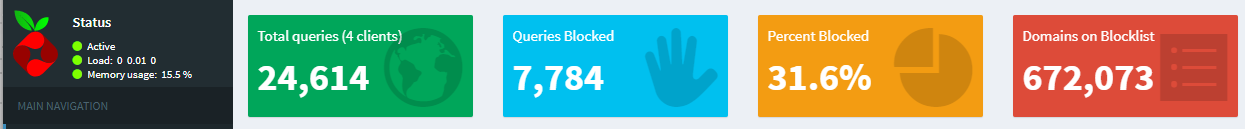

Anyone else experianceing a really low block rate on their pihole at the moment? its gone from a good 30-40% blocked to only 7-10%
https://i.~ibb.co~/BzW4Fnf/blocking.jpg
